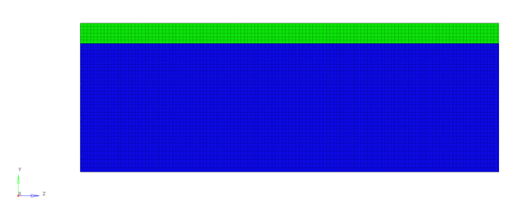

A 2D axisymmetric mesh is made of Quad elements. The element size is approximately of 0.035 cm x 0.035 cm.
Figure 3. Model mesh
Boundary condition is set on the XZ plane at y = 0 (Tx = 0, Ty = 0) to ground the model.

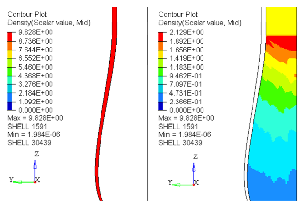

Figure 5. Density distributed in Copper and TNT at time = 11 s

Good correlation between experimental and simulation results. A thinner meshing could improve the correlation between simulation and experimental curves.
Elapsed time for simulation: t = 11 441 s, 8514 cycles, (4 cpu intel core i7 Q 840 @ 1.87 GHz).
As the model is Lagrangian, the mesh becomes very distorted at the end of the simulation to obtain a proper mesh, it is possible to use the Euler method.
