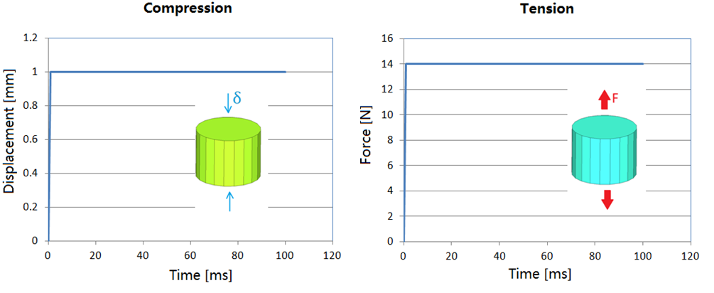

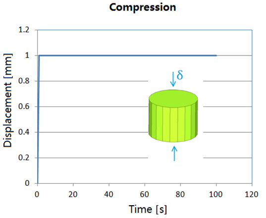

- For stress relaxation test: The foam sample has been compressed until a given strain and kept in this state.

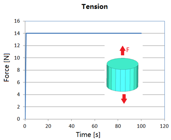

- For creep test: The foam sample has been tensile under constant force.
Figure 2. Problem Description

Figure 3. Stress Relaxation Test under Constant Displacement and Creep Test under Constant Force
For stress relaxation test: The foam sample has been compressed under constant displacement (/IMPDISP).
For creep test: The foam sample has been tensile under constant force (/CLOAD).

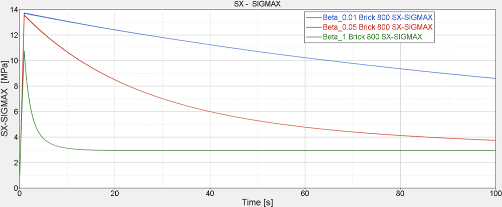

Figure 5. Stress Relieved with Different Decay Constant in Stress Relaxation Test under Constant Displacement

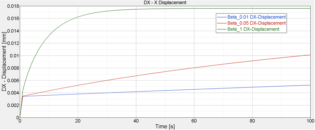

Figure 7. Sample Deformed with Decay Constant in Creep Test under Constant Force

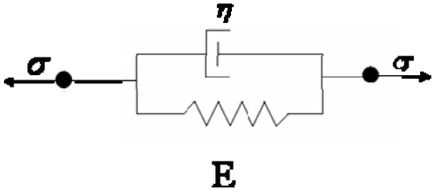

Figure 8. Maxwell Model
Figure 9. Kelvin_Voigt Model
