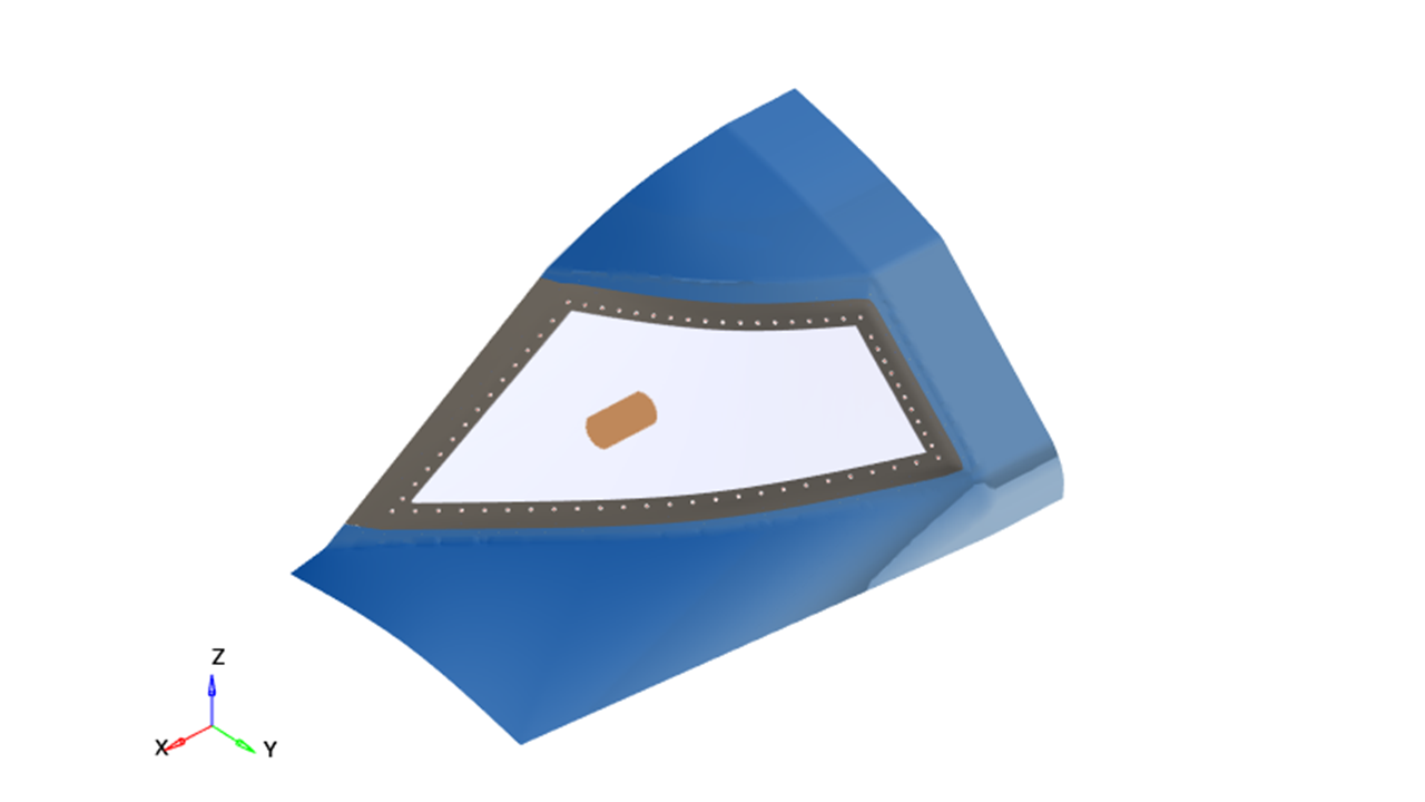

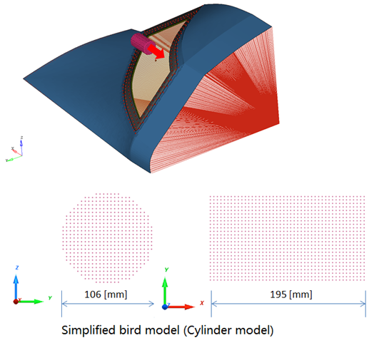

Model Description
Figure 2. Problem Description
Units: mm, ms, kg, KN, GPa
The bird model has following characteristics.

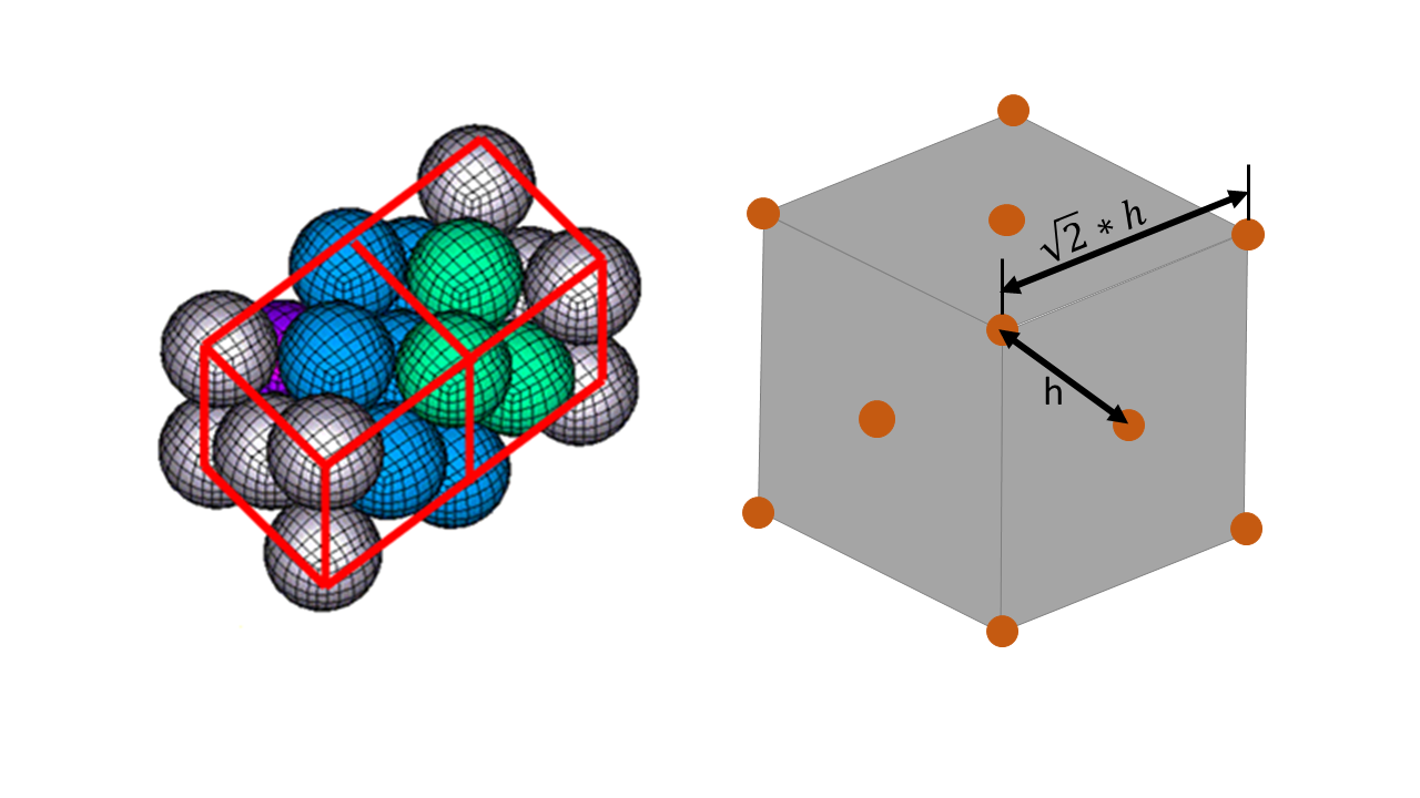

- /PROP/TYPE34 (SPH) (face centered cubic)
- mp: 1.725149e-4
- qa
- 2e-30
- qb
- 1e-30
- order
- 0
- h
- 6.286
- In property, mp is the mass of each particle. The bird model consists of 11190 particles, so the bird weighs 11190*1.725149e-4 = 1.93kg (4 pounds).
- For no damping qa was set 2e-30 and
qb to 1e-30.
To simulate a bird strike, the compression phase of the bird will be also considered; therefore, the initial compression wave should properly propagate through the bird. Energy conservation is also important, so that the bird communicates the most realistic amount of energy to the target, thus ensuring that the impact is reasonably conservative.
- In property, is smoothing length:
(1) The smoothing length, is highly recommended to use the minimal distance between each particle and its closest neighbor.
- SPH correction order is used to satisfy the consistency conditions and to ensure a better representation when the particles are not so well organized than into a hexagonal compact net. High order value is very expensive. In this example, order is set to 0.

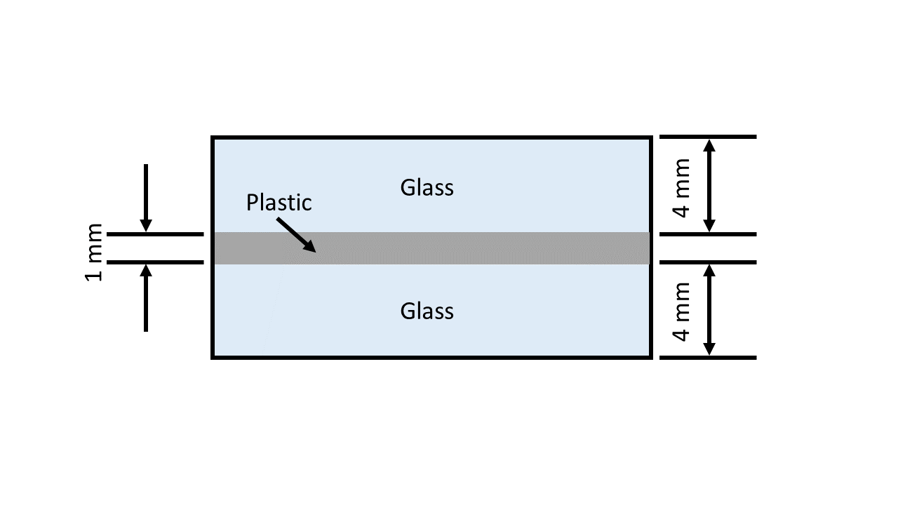

For the windshield in this example, composite material with matrix glass and plastic fabric is used. For both fabrics /MAT/LAW27 (PLAS_BRIT) (composite with isotropic layers) is used.

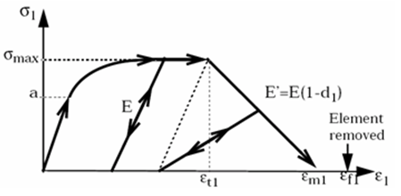

Glass Matrix
- Material Properties
- Initial density
- 1.74e-6
- E-Modules
- 61 [GPa]
- Poisson ratio
- 0.3
- Yield stress, a
- 0.045 [GPa]
- Plasticity hardening, b
- 0.05
- (Tensile failure strain in principle strain dir. 1)
- 0.01
- (Maximum tensile failure strain in principal strain dir. 1)
- 0.03
- element deleted at (Tensile strain for element deletion in principal strain dir. 1)
- 0.06

Fabric Plastic
- Initial density
- 8e-7
- E-Modules
- 3 [GPa]
- Poisson ratio
- 0.3
- Yield stress, a
- 1e30 [GPa]
- Thickness of windshield
- 9 [mm]
- Number of layers, N
- 9
- Ithick
- 1

Model Method
- Bird modelingThe bird model consists of 11190 particles, the distribution follows a hexagonal compact net. The cell distribution must be cubic face centered. The diameter of each particle is about 5.0 mm.
Figure 5. Perspective View of the Cubic Centered Faces Net - SPH simulation setupIn order to define the SPH bird, the following keywords are needed:
- /PROP/TYPE34 (SPH) to define the bird SPH cells property.
- /SPHCEL to define SPH cells for bird. Use bird part ID in this keyword.
- /SPHGLO to define the SPH parameters for the
simulation.
The default value of 0.25 for is used. This coefficient controls the search for neighbors, so that for each particle more than the actual neighbors are found. This reduces the computational time.
- Contact between SPH bird and structure and impact setup
- Interface TYPE7 is selected to simulate the contact between SPH bird and windshield structure. The windshield structure is selected as main surface and the SPH bird as secondary nodes.
- Igap=1 (use variable gap + gap scale correction + considering mesh size). The gap is ½ particle diameter + ½ thickness of the target. This is the physical value for contact.
- The stiffness between bird and windshield structure are quite different. In order to get results closer to reality, set Istf=0 and Stfac=0.1. This means interface stiffness equals to 0.1 times stiffness of main side (structure).
- /INIVEL/TRA is used to set bird part with initial velocity 80m/s strike on the structure.
- Connection between the windshield and fuselage
- For the weld connection between windshield and fuselage /PROP/TYPE13 spring beam in combination with interface TYPE2 tied contact are used.
- Other remarks
The animation out uses the H3D format via /H3D. If /ANIM output is used, the /ANIM/VERS/44 option is needed to get the best display of SPH particles.

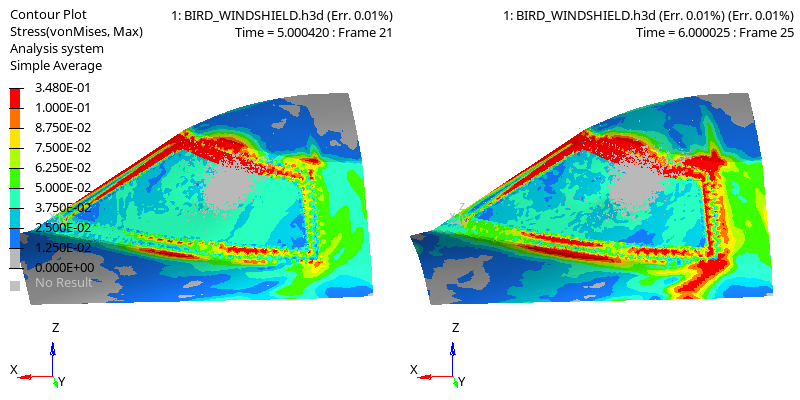

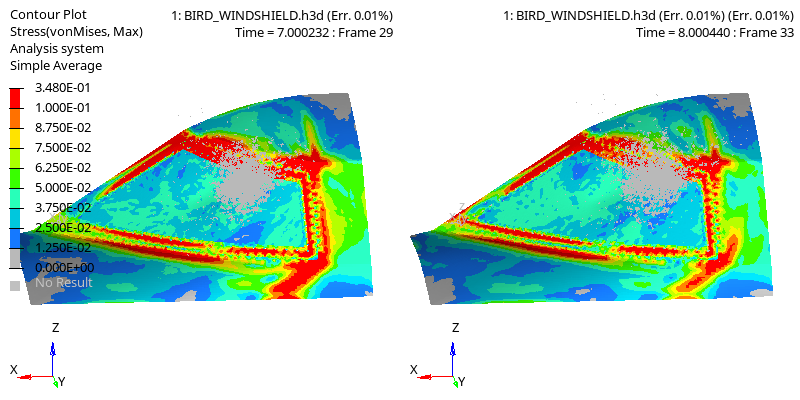

Results

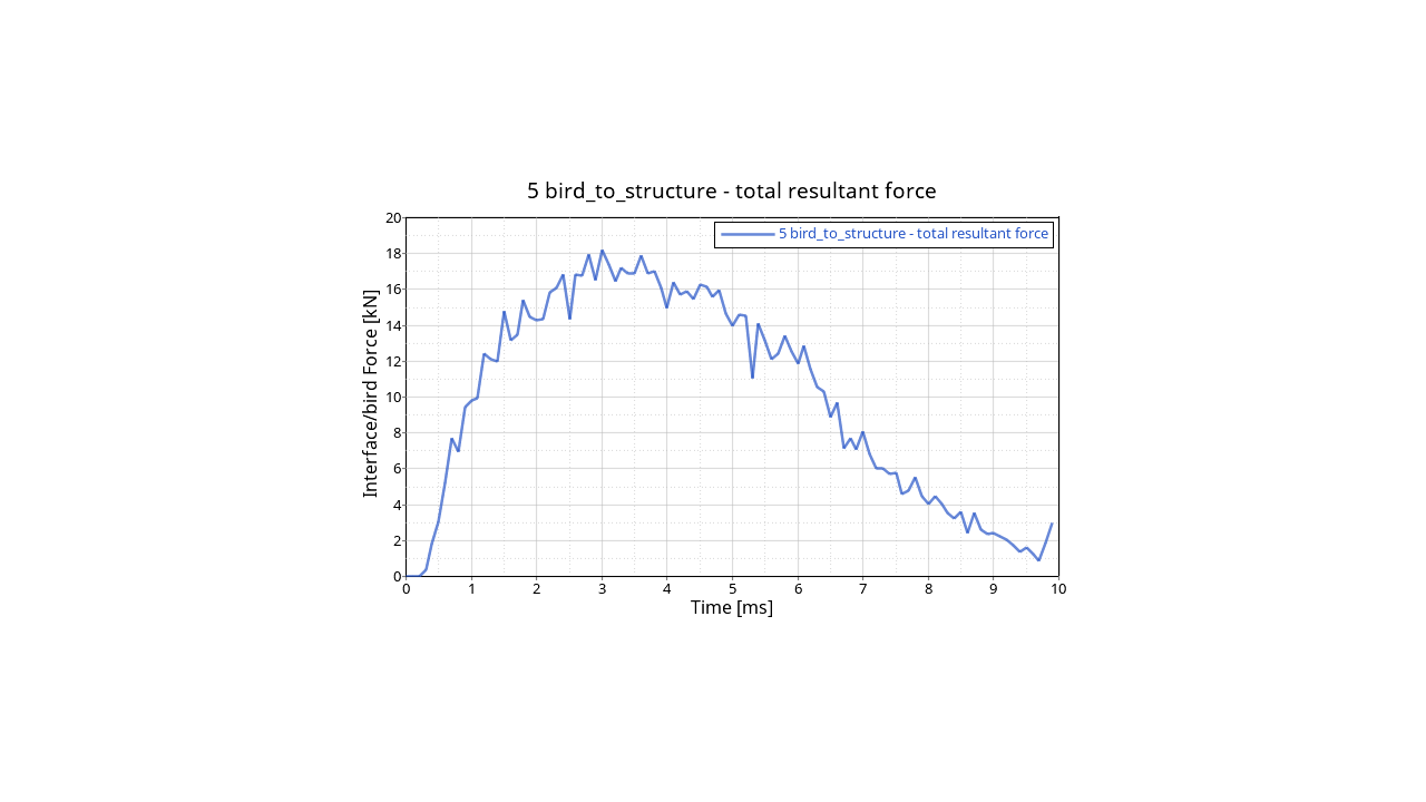

Figure 6. von Mises Stress at time 3ms~8ms
Figure 7. Interface Force between Bird and Windshield
Conclusion
- The mesh size and the number of particles of the bird model seem to be a good compromise between the accuracy of the problem and the CPU calculation time.
- For interface parameters, default values could be used. In TYPE7 contact interface, the interface stiffness Istf has to be set to zero.
- In the model a simplified hydro viscous law is used, which is well suited to describe (represent) the most important properties of the bird model.
- The smoothing length h should be set to a value larger than the inter-cell distance (to avoid excessive de-cohesion), but not too large to avoid excessive energy absorption by the particles of the bird.
- The differences between the real tests and the simulations are due to the used material models and their parameters, boundary conditions, target material laws and many other sources.
