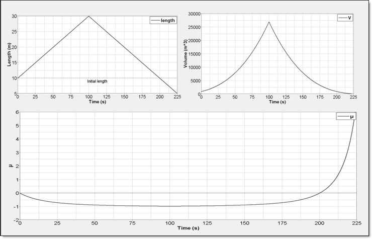

The fluid will be assumed to be a perfect gas. Volume is changed in the three directions to consider a pure compression followed by an expansion of matter (Figure 3).
This test will be modeled with a single ALE element (8 node brick) and polynomial EOS.
Evolutions of pressure, internal energy and sound speed will be compared between numerical output and theoretical results.

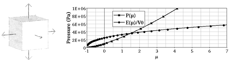

Figure 3. Elementary volume change
Simulation Iterations
A single ALE brick element is used. Material is confined inside the element by defining brick nodes as Lagrangian. For each face, displacement is imposed on the four nodes along the normal.

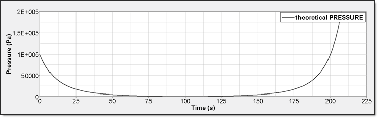

- Pressure:Perfect gas pressure is given by:
(5) Then,(6) Radioss assumes the hypothesis of an isentropic process to compute the change in internal energy:(7) This theory gives the following differential equation:(8) This has the form and the general solution is:(9) Pressure is also polytropic:(10) (11) Here, is the material constant (ratio of heat capacity). For diatomic gas =1.4. Air is made mainly of diatomic gas, so set gamma to 1.4 for air.

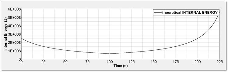

- Internal Energy:

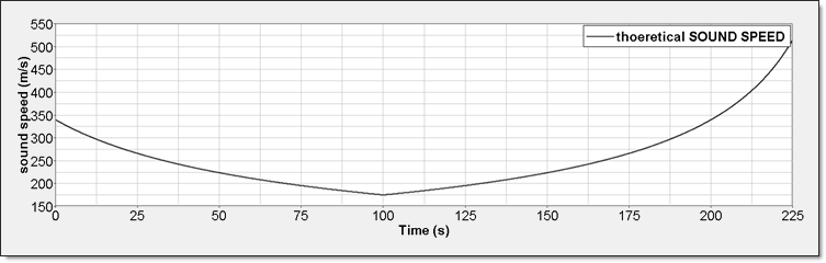

- Sound Speed:Perfect gas sound speed is:
(13) Equation 11 gives its expression in term of volume:(14)

For each of the four formulations, the computed sound speed by Radioss is the same as the theoretical one. Time step and cycle number are also not affected.

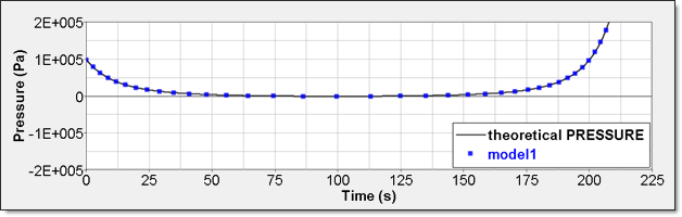

Table 4. Time History Measure Initial Value Unit /TH/BRICK () Pressure /TH (IE) Energy /TH/BRICK (IE) Pressure - Comparison with Theoretical Result:Numerical result for perfect gas pressure is given by time history. Element time history (/TH/BRICK) allows displaying it. This result is compared to a theoretical one. Curves are superimposed.

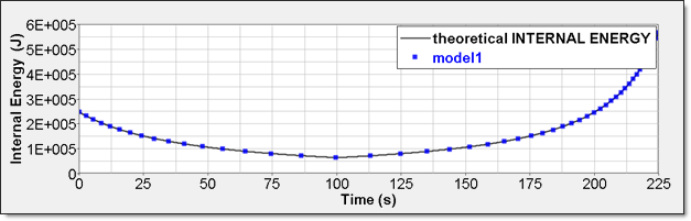

Figure 7. Numerical Pressure, Model 1Internal energy can be obtained through two different ways. The first one is internal energy density () recorded by element time history (/TH/BRICK). The second one is the internal energy from the global time history because the model is composed of a single element.
Figure 8. Numerical Internal Energy, Model 1

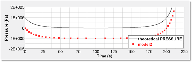

- Pressure:Equation of State:
(32) Relative Pressure:(33) Identifying with polynomial coefficients leads to:(34) Where,
Minimum Pressure:(35) Due to , the minimum pressure must be set to a non-zero value.

- Output Result:
Time History Measure Initial Value Unit /TH/BRICK () 0 Pressure /TH (IE) Energy /TH/BRICK (IE) Pressure - Comparison with Theoretical Result:
Element time history (/TH/BRICK) is the pressure relative to Psh. The resulting curve is then shifted with Psh value and starts from 0.

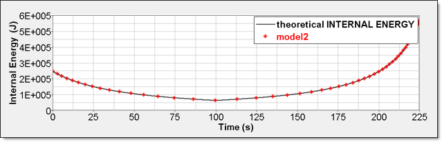

Figure 9. Numerical Pressure, Model 2Internal energy can be obtained through two different ways. The first one is internal energy density () recorded by element time history (/TH/BRICK). The second one is the internal energy from the global time history because the model is composed of a single element.
Figure 10. Numerical Internal Energy, Model 2

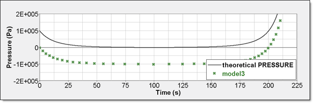

Element time history (/TH/BRICK) is the pressure relative to Psh. The resulting curve is then shifted with Psh value and starts also from 0.

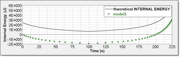

Figure 11. Numerical Pressure, Model 3Internal energy can be obtained through two different ways. The first one is internal energy density () recorded by element time history (/TH/BRICK). The second one is the internal energy from the global time history because the model is composed of a single element. This numerical internal energy is relative to its initial value; it is shifted with the value from the absolute theoretical one and also starts from 0.
Figure 12. Numerical Internal Energy, Model 3

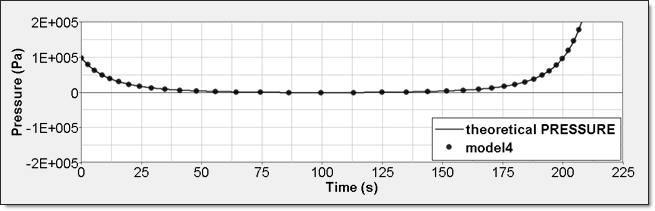

Time History Measure Initial Value Unit /TH/BRICK () Pressure /TH (IE) 0 Energy /TH/BRICK (IE) 0 Pressure - Comparison with Theoretical Result:Element time history (/TH/BRICK) gives absolute pressure. This result is compared to a theoretical one. Curves are superimposed.

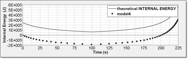

Figure 13. Numerical Pressure, Model 4Internal energy can be obtained through two different ways. The first one is internal energy density () recorded by element time history (/TH/BRICK). The second one is the internal energy from the global time history because the model is composed of a single element. This numerical internal energy is relative to its initial value; it is shifted with the value from the absolute theoretical one and also starts from 0.
Figure 14. Numerical Internal Energy, Model 4
