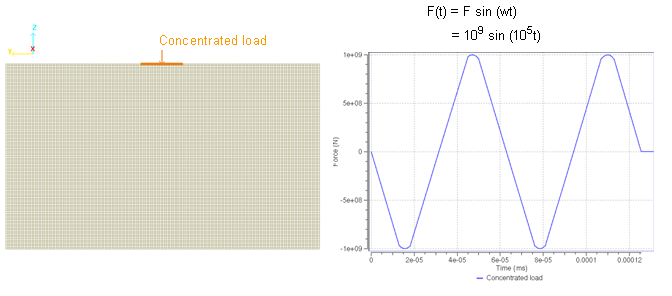

- Concentrated load (/CLOAD)The applied vertical pulse is a concentrated load (/CLOAD) in the form of a sinusoidal function having an amplitude GPa and a time period of .
Figure 2. Variation of the Impulse Load Over Time - Function (/FUNCT)

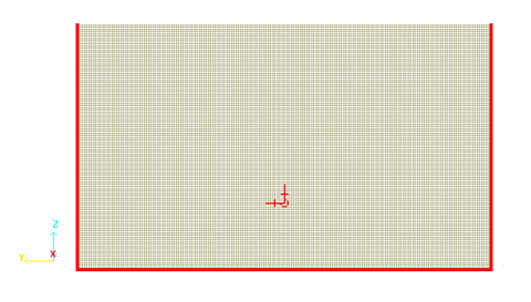

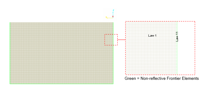

- Non-reflective frontiers (NRF) material LAW11 (/MAT/LAW11 (BOUND))
Figure 3. Fixed Sides
The limitation of this approach is the reflection on the domain's boundaries. Simulation results are shown for the point in time prior to the shock hitting the low side (< 0.77 ms).

Figure 4. Infinite Domain Modeled by the Non-reflective Frontiers (NRF) Material LAW11 (TYPE3)
The materials have to be declared ALE using /ALE/MAT in the input desk.

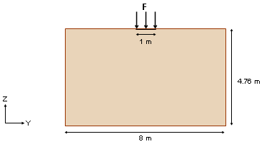

Model Description
Units: m, s, Kg, N, Pa.
Figure 5. Problem Data
- Material Properties
- Initial density
- 2842 kg.m-3
- Young's modulus
- 73 GPa
- Poisson ratio
- 0.33

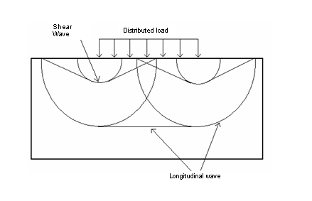

The expansion process of the shock wave is comprised of the longitudinal and shear waves.
Based on these material properties, the propagation speed of longitudinal waves in the material correspond to 6169.1 m.s-1 and 3107.5 m.s-1 for shear waves. Thus, the longitudinal waves should reach the lower boundary of the domain in about 0.77 ms.
Figure 6. Longitudinal and Shear Waves Comprising the Wave Pattern
The impulse load is described by the sinusoidal function:

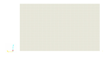

The part is modeled using a regular mesh with 19080 QUAD elements (44.9 mm x 44.4 mm with =63.15 mm).
Figure 7. Mesh of the Bi-dimensional Domain

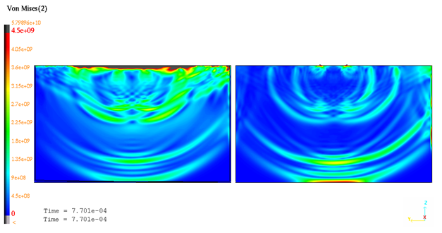

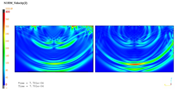

Comparison of Lagrangian and ALE Results with the Analytical Solution

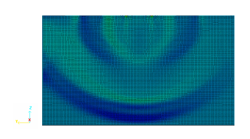

Figure 8. von Mises isovalues at t=0.77 ms
Figure 9. Velocity isovalues at t=0.77 ms
The shock wave propagation is well predicted. Simulation results obtained at t=0.77ms corroborate the analytical solution: Longitudinal and shear waves.

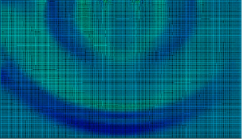

Wave Pattern
Figure 10. Wave Pattern in Domain at t=0.77 ms

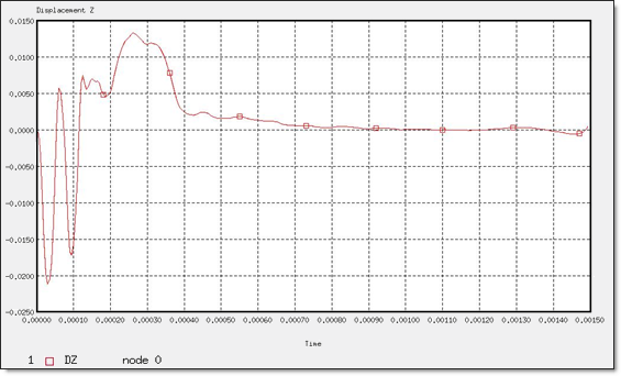

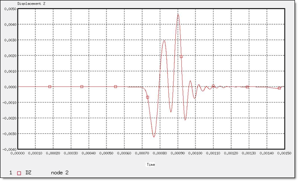

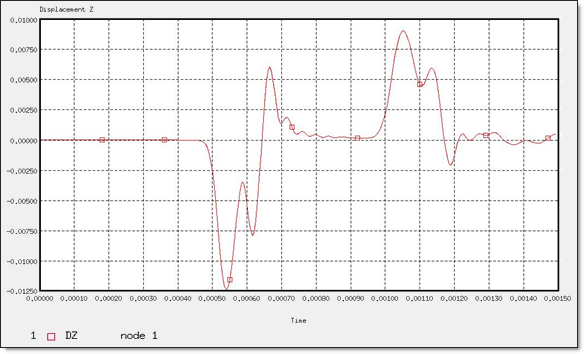

Vertical Displacement

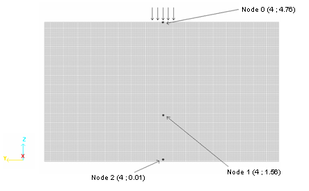

Figure 11. Nodes Saved in Time History
Figure 12. Z-displacement of "Node 0"
Figure 13. Z-displacement of "Node 1"
Figure 14. Z-displacement of "node 2"

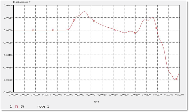

Horizontal Displacement
Figure 15. Y-displacement of "node 0"

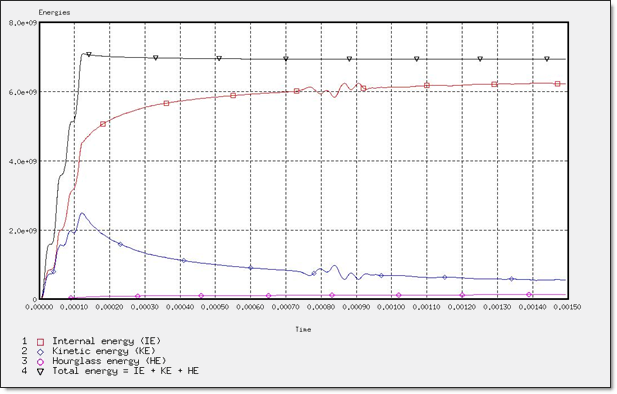

Figure 16. Global Energy Assessment

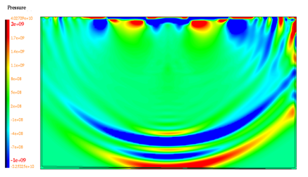

Figure 17. Pressure isovalues at time t=0.77 ms

The wave propagation in a finite domain is studied using Lagrangian and ALE approaches. The Lagrangian formulation does not allow an infinite domain to be defined. Reflections of the longitudinal and shear waves against boundaries restrict simulation in terms of time (t < 0.77 ms). The ALE approach allows you to model an infinite domain by defining the non-reflective frontiers (NRF) material (LAW11 - TYPE3) on the limits. Such specific modeling minimizes the reflection of the expansion wave.
The bi-dimensional analysis illustrates a planar propagation. An accurate representation of the wave pattern is obtained and the simulation results are in a closed agreement with the analytical solution.
