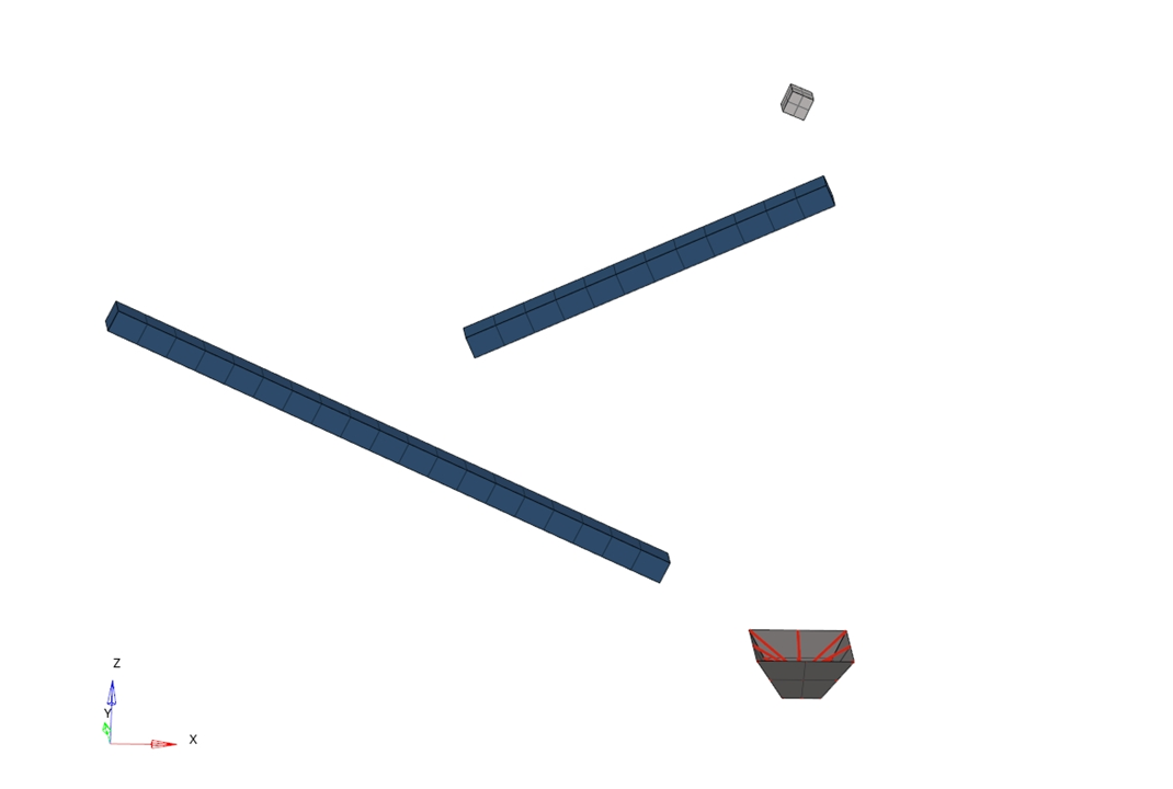

Ice cube dropping on two sliding channels.
The subject in this example demonstrates the falling and sliding of an ice cube on to sloped beams using an explicit transient dynamic analysis for deformable, free-flying objects. The impact and rebound are modeled using penalty contact algorithms.
The Contact between the ice cube, the beams, and the cup are modeled using different penalty contact interfaces (/INTER/TYPE7, /INTER/TYPE24 and /INTER/TYPE25). The ice cube and the beams are modeled using hexahedron elements. The cup is modeled with standard shell elements.

This problem provides a comparison of different contact interfaces that allow sliding contact between an ice cube and steel beams.
The cube is submitted to gravity and slides on declined fixed beams. Finally, it is collected in a cup. The width of the cube is 30 mm and the dimensions of the beams are 40 x 30 x 500 mm.

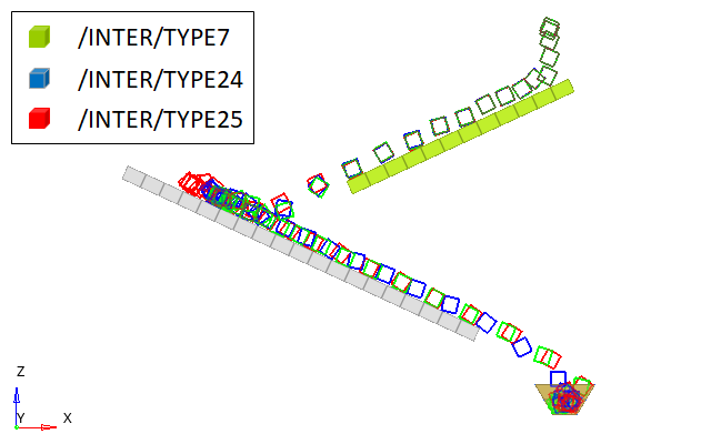

Figure 2. Trajectory of the Ice Cube using Interface TYPE7, TYPE24 and TYPE25

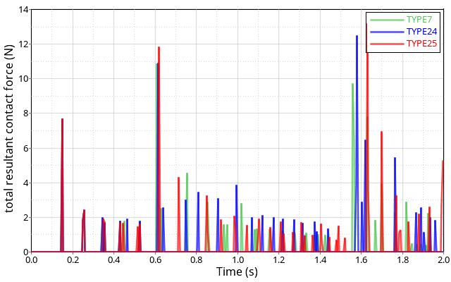

Figure 3. Comparison of the Reaction Forces of the Ice Cube on the Beams
