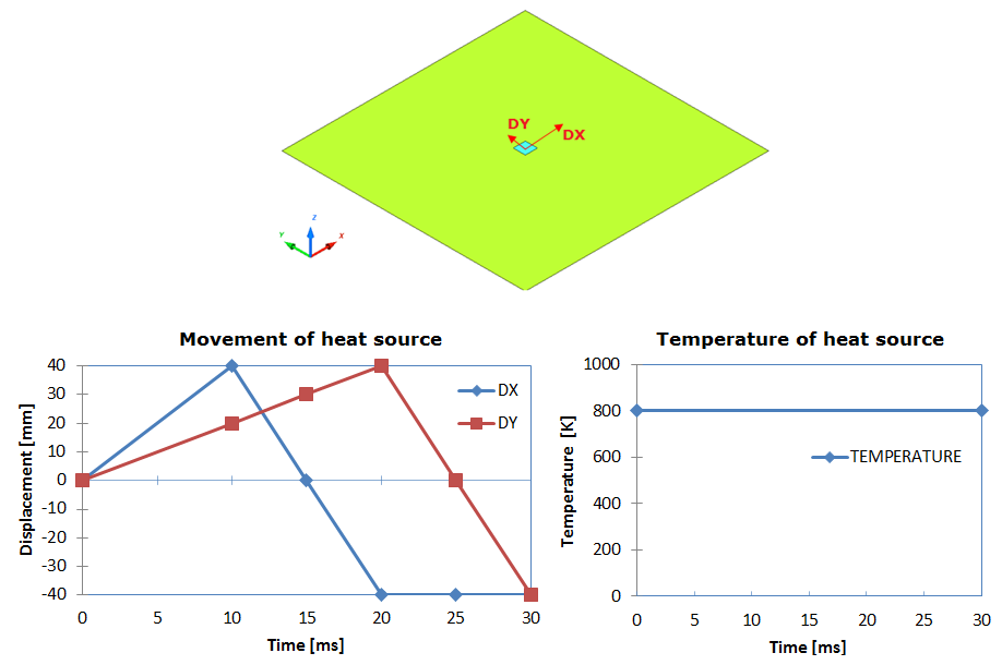

A heat source moved on one plate. Heat exchanged between a heatsource and a plate through contact, also between a plate and theatmosphere (water) through convective flux.

Figure 2. Problem Description
Units: mm, ms, g, N, and MPa

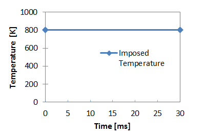

Figure 3. Imposed Temperature for Heat Source

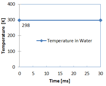

Figure 4. Water Temperature
Where, H is the heat transfer coefficient between structural component and its surrounding infinite room with unit . In general, the convective heat transfer coefficient for water (free convection) is about 20 - 100 and water (forced convection) is about 50 - 10000 . Forced convection in water is .

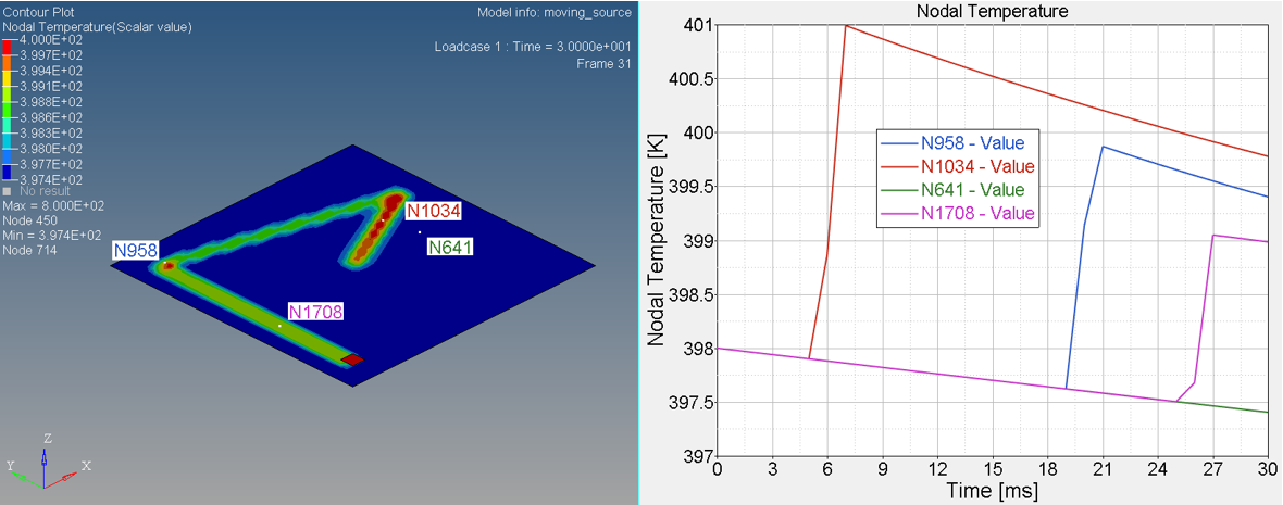

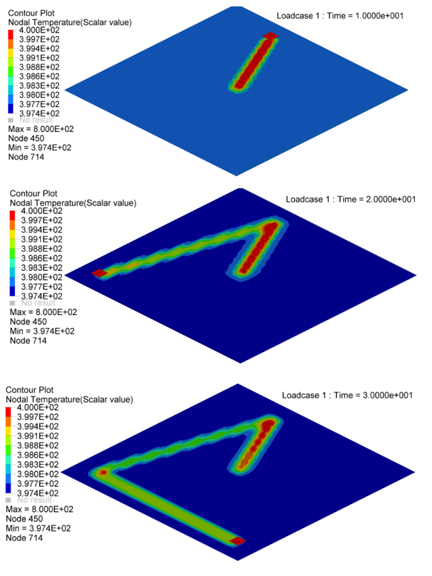

Results

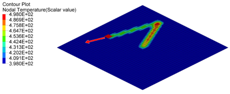

Figure 5. Nodal Temperature in Plate at time=10[ms], 20[ms] and 30[ms]
- Nodal N641 is not under trace. The temperature changed, only due to convection with water.
- Nodal N1034, N958 and N1708 are under trace. At first the temperature
decreased before the heat source began, due to convection with water, and
then increased, due to the heat exchange from the heat source through
contact. Once the heat source is removed, the temperature decreased again,
due to the heat conduction inside the material and convection with water. So
the slope of the temperature decrease is much larger than N641 (only
convection).
Figure 6. Temperature on Nodal N641, N1034, N958 and N1708
