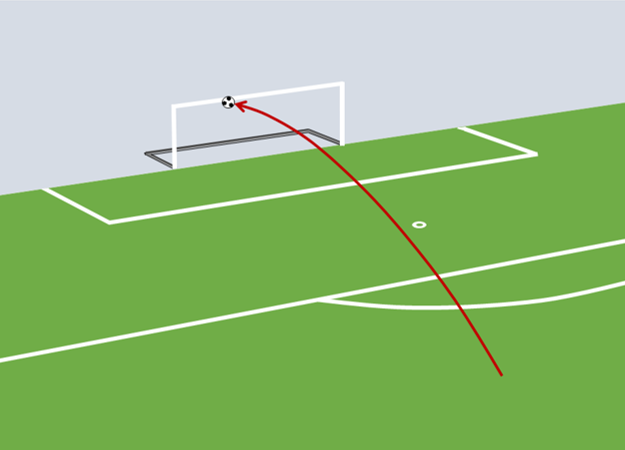

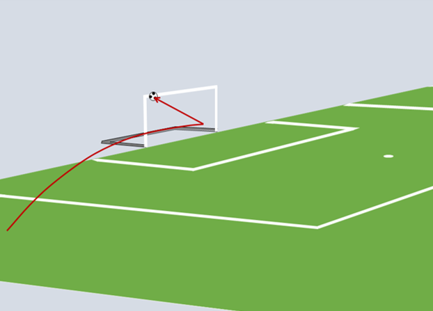

Figure 2. Trajectory of the Soccer Ball of Bathenay's Shot
Figure 3. Trajectory of the Soccer Ball of Santini's Header

During the European football (Soccer) Cup final in 1976 (Bayern of Munich versus Saint Etienne), a shot from Bathenay and a header from Santini rebounded off the square cross-section frame of the German team's goal. The purpose of this demonstration is to determine the influence of a square or a round cross-section bar for both cases.
The main differences between both shots are the incidence, the velocity and the impact point of the ball on the bar (its vertical value).

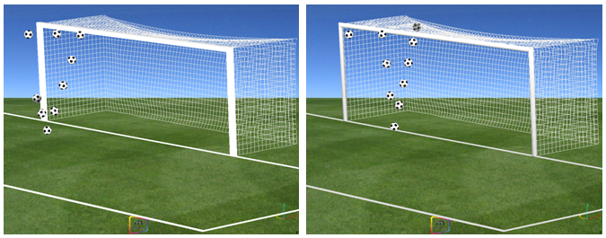

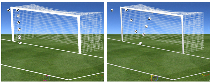

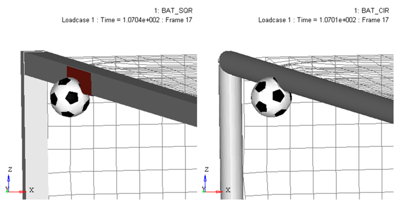

Figure 6. Impact of the Soccer Ball on a Square and a Round Cross-section

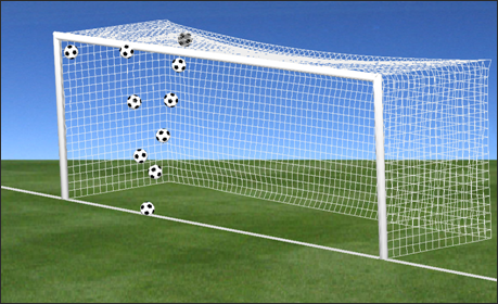

Figure 7. Trajectory of the Ball for Bathenay's Shot. (impact on a square and a round bar, respectively)
Figure 8. Trajectory of the Ball for Santini's Head. (impact on a square and a round bar, respectively)

Even using a simple modeling of the impact (bars modeled with rigid walls instead of parts), the simulation provides quite accurate results in the case of a square cross-section when simulations are compared to reality. The results obtained for the bars with a round cross-section show that the ball enters the goal for both shots. However, several impact parameters, such as friction and rotational velocity are estimated as calibrating the case of a square cross-section.
