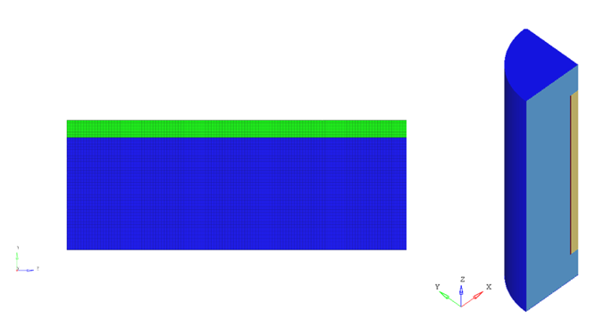

- Axisymmetric mesh of a cylinder with four node quad elements (for Lagrangian Approach)
- 3D mesh of a quarter-cylinder with eight node brick elements (for Eulerian Approach)
