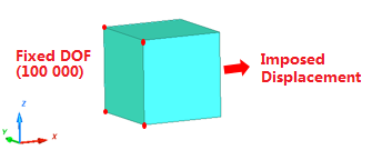

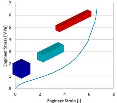

Uniaxial tensile one brick element with imposed displacement and fixed in other side only in X direction.
Figure 2. Problem Description

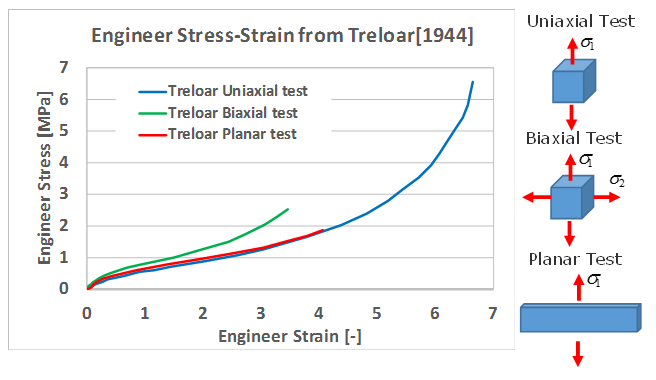

Figure 3. Test Data from Treloar [1944]

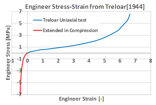

The engineering strain should be monotonically increasing going from a negative value in compression to a positive value in tension. In compression, the engineering strain should not be less than -1.0 since -100% strain is physically not possible. Fitting test data that represents the anticipated strain state of material will give the most accurate material parameters for a particular situation. Although a tension only uniaxial stress strain curve could be used, this example uses uniaxial compression and tension data to better fit for both compressive and tension loading conditions.

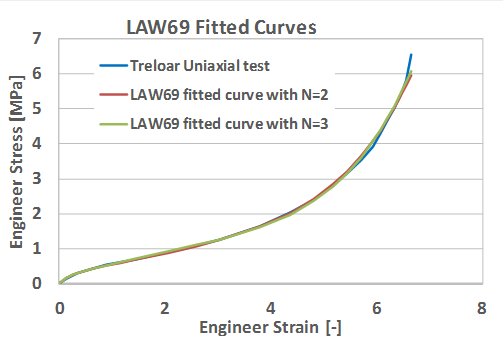

Figure 4. LAW69 Fitted Curve with N=2 and N=3 for Odgen Model

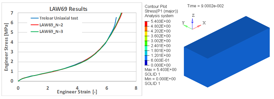

Figure 5. LAW69 Results from a 1 Element Model with N=2 and N=3
Figure 5 shows the calculated stress strain curve from the 1 element model simulation matches the Treloar test data.
The engineering stress strain curves were calculated from the true stress and true strain in principal direction 1 (P1) from the animation output /ANIM/BRICK/TENS/STRAIN and /ANIM/BRICK/TENS/STRESS using these formulas.

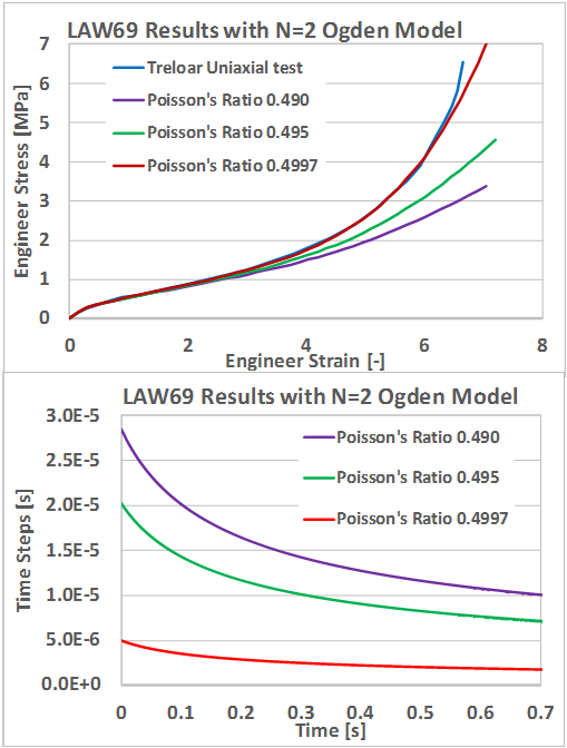

The effect of different Poison’s ratio input can be seen in Figure 6. The largest difference in the results is at higher amounts of strain. The results will match the test data better when but this results in a time step that is 4 times lower than . Thus, to balance the computation time and accuracy it is recommended to use for incompressible rubber material.
Figure 6. Effect of Poisson’s Ratio in Results and in Time Step

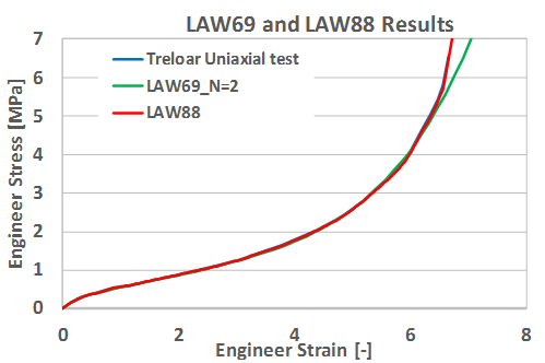

Figure 7. Results of LAW69 and LAW88 Compared with Test Data
Figure 8. Test Data Extended in Compression

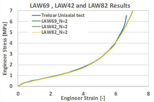

Figure 9 shows the material fit parameters from LAW69 converted into LAW82 match the LAW69 and LAW42 results for Ogden order, N=2.

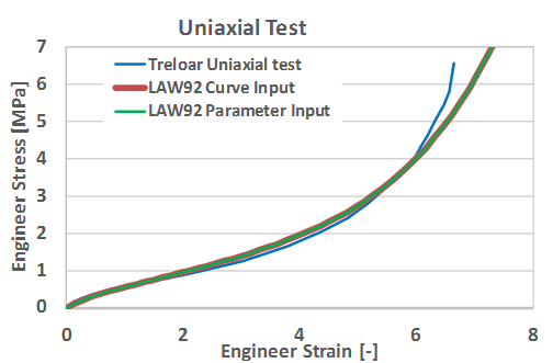

Figure 13. Equivalent LAW92 Used with Curve Input and Parameter Input

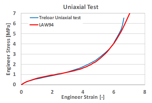

/MAT/LAW94/1
plastic
# RHO_I
1.0E-9
#Blank
# C10 C20 C30
0.184883390008739 -0.001996532878013 0.000047314869715
# D1 D2 D3
0.003245938015181
#ENDDATA
Figure 15. Results of LAW94 with Fitted Yeoh Parameter
