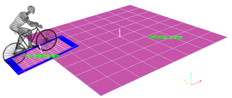

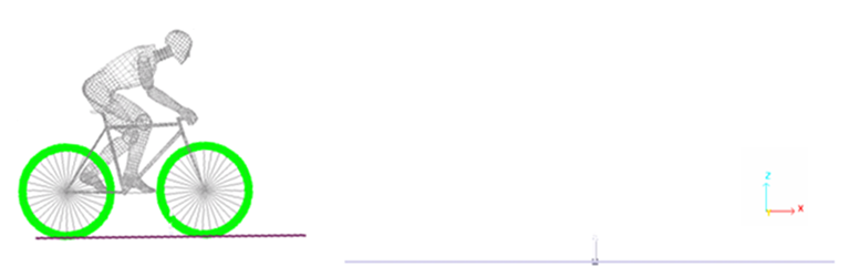

Two types of rigid walls are set up:
  • A fixed infinite plane (floor)
  • A fixed parallelogram (springboard)
rad_ex_fig_12-9
Figure 2. Position of the Rigid Walls
The characteristics of the parallelogram plane are: 2013 mm x 1200 mm. Both rigid walls are tied to allow the wheels to turn.
The infinite plane is defined by the normal vector ( M M 1 MathType@MTEF@5@5@+= feaagKart1ev2aaatCvAUfeBSjuyZL2yd9gzLbvyNv2CaerbwvMCKf MBHbqefqvATv2CG4uz3bIuV1wyUbqedmvETj2BSbqefm0B1jxALjhi ov2DaebbnrfifHhDYfgasaacH8srps0lbbf9q8WrFfeuY=Hhbbf9v8 qqaqFr0xc9pk0xbba9q8WqFfea0=yr0RYxir=Jbba9q8aq0=yq=He9 q8qqQ8frFve9Fve9Ff0dmeaacaGacmGadaWaaiqacaabaiaafaaake aadaWhcaqaaiaad2eacaWGnbWaaSbaaSqaaiaaigdaaeqaaaGccaGL xdcaaaa@3D20@ ) and the parallelogram by the coordinates of three corners ( M , M 1 , and M 2 ). For both rigid walls, the secondary nodes are obtained from the tire and rim parts (displayed in green in Figure 3).
Figure 3. Secondary Nodes Definition (green) and Profile View of Rigid Walls

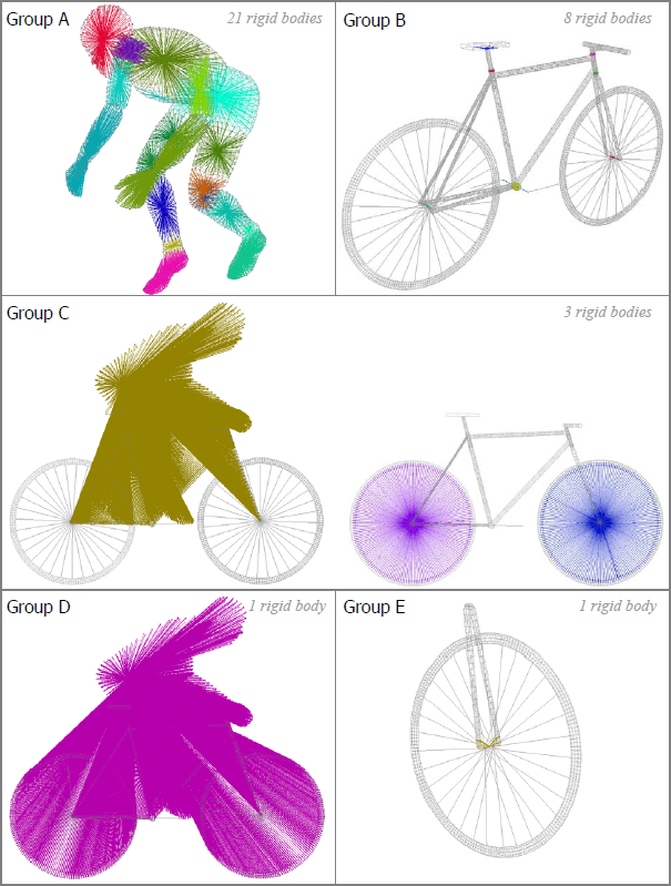

Several rigid bodies are created (/RBODY) and activated by sensors for use at the appropriate time and in a chronological manner (sens_ID not equal to 0). Thus, every rigid body is not active at the same time. The activation order is described in the paragraph dedicated to /SENSOR. According to their activation time, the rigid bodies are classified in groups which are:
rad_ex_fig_12-11
Figure 4. Classification of Rigid Bodies (group)

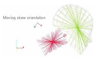

The inertias of rigid bodies are set in local skew frames for groups A, C and D.
Rigid body activation/deactivation
Groups A and B
The rigid bodies are activated during pre-loading up to equilibrium then applied to the initial velocity start. They are activated again just before the impact of the bike on the inferior plane.
During the free fly phase, both the cyclist and the bike undergo a rigid body motion. In order to save the computation time, the motion can be simulated by putting the whole structure into a global rigid body (Group D). The rigid body is deactivated just before landing.
Group C
Three rigid bodies include the dummy, the frame and both wheels (not including the tires). This configuration allows just the wheels to turn, taking into account the active tires action on the plane. This rigid body is activated while the bike is running on the springboard.
Group D
This global rigid body, including all nodes of model is activated as long as the bike is in the free fly phase and is deactivated just before impact on the floor.
Group E
This rigid body is activated before impact ensures the stiffness level of the lower fork.

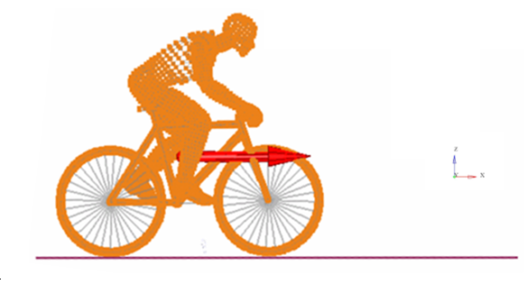

A 8333 mms-1(30 km/h) initial velocity (/INIVEL) is applied to all nodes of the model (bicycle and cyclist) in a parallel direction to the high plane at time t = 0.004 s. This initial condition is defined in the Engine file *_0002.rad (start time: 0.004 s) which is run after the quasi-static equilibrium with gravity loading.
Options in Engine file (*_0002.rad):
/INIV/TRA/X/1
initial translational velocities in direction x
8333
of 8333 mm/s
1 338000
on node 1 to 338000
rad_ex_fig_12-12
Figure 5. Initial Translational Velocities of the Model Bike/Man (30 km/h) at t = 0.004 s

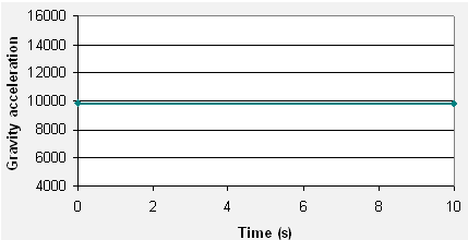

Gravity is applied to all nodes of the model. A constant function defines the gravity acceleration in the Z direction versus time. Gravity is activated by /GRAV.
rad_ex_fig_12-13
Figure 6. Gravity Function (-9810 mm/s-2)

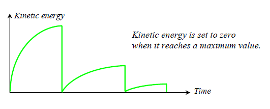

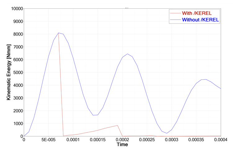

The explicit time integration scheme starts with the nodal acceleration computation. It is efficient for the simulation of dynamic loadings. Nevertheless, quasi-static simulations via a dynamic resolution method need to minimize the dynamic effects to converge towards the static equilibrium. Among the methods usually employed, the kinetic relaxation method is quite effective and is activated in the Engine file (*_0001.rad) with /KEREL (Figure 7). All velocities are set to zero each time the kinetic energy reaches a maximum value.
rad_ex_fig_12-14
Figure 7. Kinetic Relaxation Method

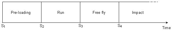

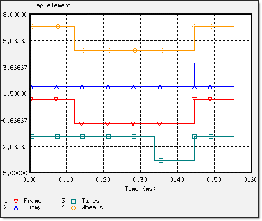

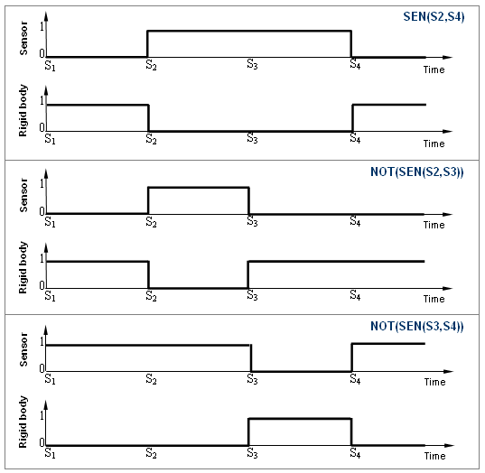

Rigid bodies are activated and deactivated with sensors (/SENSOR). A sens_ID flag characterizes the sensors and it is required in the rigid bodies' definition. The five types of sensors used are:
TIME
Activated with time
DIST
Activated with nodal distance
INTER
Activated after impact on rigid wall
SENSOR
Activated with sensor IS1 and deactivated with sensor IS2
NOT
ON as long as sensor IS1 is OFF
rad_ex_fig_12-15
Figure 8. Events Definition for the Activations and Deactivations of Sensors
At the beginning of the simulation (time=0), the rigid bodies are automatically set to ON, as long as the sensors are not active. Thus, in order to deactivate the rigid bodies at the first cycle, active sensors at time t=0 should be used. Consequently, the rigid bodies are active when the sensors are not active.
Added masses and inertia, as well as the flag for the gravity center, are ignored when a rigid body is managed by sensors. By default, the gravity center is only computed by taking into account the secondary nodes mass (ICoG set at 2). The main node is moved to the computed center of gravity where added mass and inertia are placed. In order to distribute the mass to the dummy over the rigid bodies, option /ADMAS is used.
Table 1. Sensors Used for Simulation
Name Type Definition Rigid Body's Group using Sensor
S1 TIME Time 0s. -
S2 DIST Distance between rear hubs and extremity of springboard equal to 1810 mm. -
S3 DIST Distance between rear hubs and extremity of springboard equal to 345 mm. -
S4 RWALL When the infinite rigid wall is impacted. -
SEN(S2,S3) SEN Activated with S2 and deactivated with S3 -
SEN(S3,S4) SEN Activated with S3 and deactivated with S4 -
SEN(S2,S4) SEN Activated with S2 and deactivated with S4 Group A/B
NOT(SEN(S2,S3)) NOT Deactivated with S2 and activated with S3 Group C
NOT(SEN(S3,S4)) NOT Deactivated with S3 and activated with S4 Group D
Sensor (S4) is also used for deactivating both the beam type springs modeling links between the feet and pedals (Ishear set to 1). A case could be considered without this sensor to study the risks of automatic pedals.
rad_ex_fig-12-16
Figure 9. Activation and Deactivation Zones of Sensors and Rigid Bodies

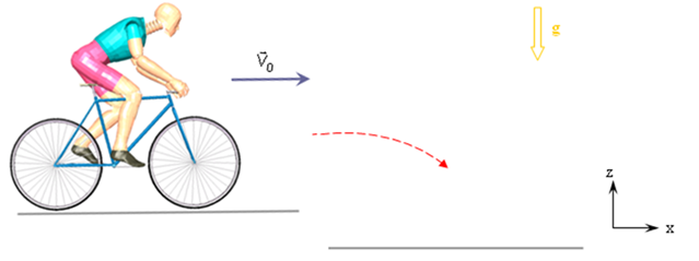

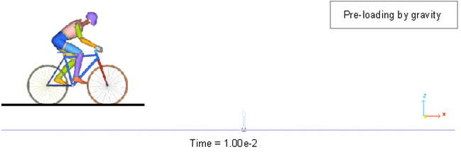

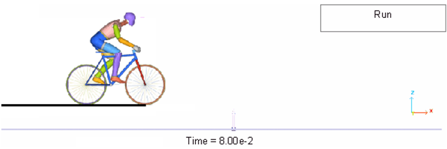

The purpose of this example is to set up a demonstration in which sensors and restart files are used to allow the change of a problem over time.
Subjected to the gravity field, a dummy cyclist rides on a higher plane, then jumps down onto a lower horizontal plane. The problem can be divided into four phases:
  • positioning the cyclist under the gravity effect
  • running the bicycle on the high plane
  • free fly
  • the impact on the ground
The following system is used: Ton, mm, s, N, MPa

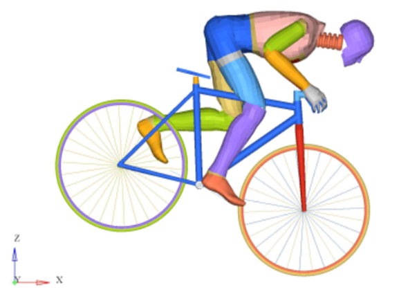

rad_ex_fig_12-1A
Figure 10.
rad_ex_fig_12-1B
Figure 11.

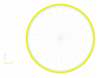

Monitored Volumes / Perfect Gas
A perfect gas monitored volume with /MONVOL/GAS is defined to model the pressure in the tires. For further details about monitored volumes, refer to GAS Type in the Radioss Theory Manual.
The main properties are:
External pressure Pext
0.1 [ MPa ] MathType@MTEF@5@5@+= feaagKart1ev2aqatCvAUfeBSjuyZL2yd9gzLbvyNv2CaerbuLwBLn hiov2DGi1BTfMBaeXatLxBI9gBaerbd9wDYLwzYbItLDharqqtubsr 4rNCHbGeaGqiVu0Je9sqqrpepC0xbbL8F4rqGqFfpeea0xe9vq=Jb9 vqpeea0xd9q8qiYRWxGi6xij=hbba9q8aq0=yq=He9q8qiLsFr0=vr 0=vr0db8meaabaqaciGacaGaaeqabaWaaeaaeaaakeaadaWadaqaai Gac2eacaGGqbGaaiyyaaGaay5waiaaw2faaaaa@3BE6@
Initial internal pressure Pini
Front tire: 0.75 [ MPa ] MathType@MTEF@5@5@+= feaagKart1ev2aqatCvAUfeBSjuyZL2yd9gzLbvyNv2CaerbuLwBLn hiov2DGi1BTfMBaeXatLxBI9gBaerbd9wDYLwzYbItLDharqqtubsr 4rNCHbGeaGqiVu0Je9sqqrpepC0xbbL8F4rqGqFfpeea0xe9vq=Jb9 vqpeea0xd9q8qiYRWxGi6xij=hbba9q8aq0=yq=He9q8qiLsFr0=vr 0=vr0db8meaabaqaciGacaGaaeqabaWaaeaaeaaakeaadaWadaqaai Gac2eacaGGqbGaaiyyaaGaay5waiaaw2faaaaa@3BE6@
Rear tire: 0.1 [ MPa ] MathType@MTEF@5@5@+= feaagKart1ev2aqatCvAUfeBSjuyZL2yd9gzLbvyNv2CaerbuLwBLn hiov2DGi1BTfMBaeXatLxBI9gBaerbd9wDYLwzYbItLDharqqtubsr 4rNCHbGeaGqiVu0Je9sqqrpepC0xbbL8F4rqGqFfpeea0xe9vq=Jb9 vqpeea0xd9q8qiYRWxGi6xij=hbba9q8aq0=yq=He9q8qiLsFr0=vr 0=vr0db8meaabaqaciGacaGaaeqabaWaaeaaeaaakeaadaWadaqaai Gac2eacaGGqbGaaiyyaaGaay5waiaaw2faaaaa@3BE6@
Gas constant γ
1.4
All other properties are set to default values.
rad_ex_fig_12-3
Figure 13. Visualization of a Monitored Volume (yellow part)

The general TYPE8 springs, characterize a spherical hinge with a stiffness given for each DOF. Directions are local and attached to a moving skew frame. Two coinciding nodes define a spring.
Limbs are linked to the springs via the secondary nodes of the rigid bodies, as shown in Figure 17.
rad_ex_fig_12-7
Figure 17. Connection Rigid Body - Spring TYPE8 - Rigid Body

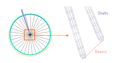

  • Wheel rotation
Beam elements are used to attach the wheel to the forks. The rotational DOF is released around the beam axis.
rad_ex_fig_12-8
Figure 18. Wheel/Forks Junction

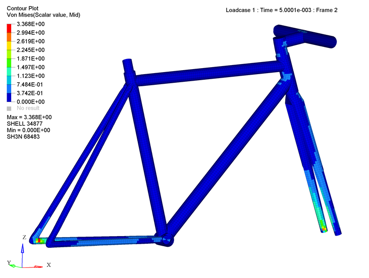

Results
The elements included in a rigid body are deactivated. Therefore, the element flags saved in /TH/RBODY provide information on the activation and deactivation of rigid bodies during simulation.
rad_ex_fig-12-17
Figure 19. Activation and Deactivation of Main Model Parts (elements flag ON/OFF)
rad_ex_fig_12-18
Figure 20. Distribution of the von Mises Stress on the Frame after Quasi-static Loading

Figure 21. Kinetic Relaxation Effect on Kinetic Energy with /KEREL

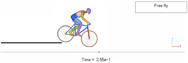

rad_ex_fig_12-21A rad_ex_fig_12-21B rad_ex_fig_12-21C rad_ex_fig_12-21D

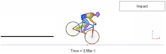

Figure 22. Simulation Phases (impact at t = 4.6 s)
rad_ex_fig_12-22
Figure 23. Dummy Cyclist during Impact on the Ground (shoes not attached)

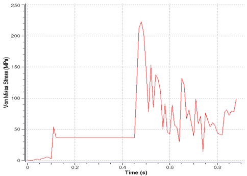

rad_ex_fig_12-23
Figure 24. Variation of von Mises Stress for a Shell Element of the Frame
