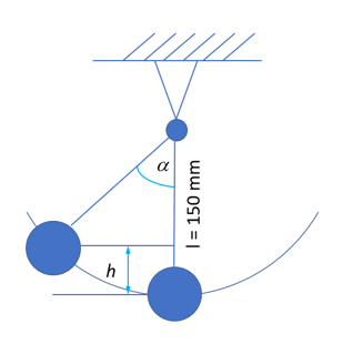

When considering the kinetic energy variation of the model, the system behaves as a simple pendulum (Figure 3).
When the pendulum mass is released at time t=0, Ball 5 (end ball) has maximum potential energy and zero kinetic energy. Ball 5 achieves maximum velocity before striking the four other pendulums. For a moderate case that is without loss, you have:(1) E p o t = E k i n m g h = 1 2 m v 2 MathType@MTEF@5@5@+= feaagKart1ev2aaatCvAUfeBSjuyZL2yd9gzLbvyNv2CaerbuLwBLn hiov2DGi1BTfMBaeXatLxBI9gBaerbd9wDYLwzYbItLDharqqtubsr 4rNCHbGeaGqiVu0Je9sqqrpepC0xbbL8F4rqqrFfpeea0xe9Lq=Jc9 vqaqpepm0xbba9pwe9Q8fs0=yqaqpepae9pg0FirpepeKkFr0xfr=x fr=xb9adbaqaaeGaciGaaiaabeqaamaabaabaaGceaqabeaacaWGfb WaaSbaaSqaaiaadchacaWGVbGaamiDaaqabaGccqGH9aqpcaWGfbWa aSbaaSqaaiaadUgacaWGPbGaamOBaaqabaaakeaacaWGTbGaam4zai aadIgacqGH9aqpdaWcaaqaaiaaigdaaeaacaaIYaaaaiaad2gacaWG 2bWaaWbaaSqabeaacaaIYaaaaaaaaa@46E4@
Where,
h MathType@MTEF@5@5@+= feaagKart1ev2aaatCvAUfeBSjuyZL2yd9gzLbvyNv2CaerbuLwBLn hiov2DGi1BTfMBaeXatLxBI9gBaerbd9wDYLwzYbItLDharqqtubsr 4rNCHbGeaGqiVu0Je9sqqrpepC0xbbL8F4rqqrFfpeea0xe9Lq=Jc9 vqaqpepm0xbba9pwe9Q8fs0=yqaqpepae9pg0FirpepeKkFr0xfr=x fr=xb9adbaqaaeGaciGaaiaabeqaamaabaabaaGcbaGaamiAaaaa@36E3@
Vertical displacement of the ball’s center
v MathType@MTEF@5@5@+= feaagKart1ev2aaatCvAUfeBSjuyZL2yd9gzLbvyNv2CaerbuLwBLn hiov2DGi1BTfMBaeXatLxBI9gBaerbd9wDYLwzYbItLDharqqtubsr 4rNCHbGeaGqiVu0Je9sqqrpepC0xbbL8F4rqqrFfpeea0xe9Lq=Jc9 vqaqpepm0xbba9pwe9Q8fs0=yqaqpepae9pg0FirpepeKkFr0xfr=x fr=xb9adbaqaaeGaciGaaiaabeqaamaabaabaaGcbaGaamODaaaa@36F1@
Velocity
m MathType@MTEF@5@5@+= feaagKart1ev2aaatCvAUfeBSjuyZL2yd9gzLbvyNv2CaerbuLwBLn hiov2DGi1BTfMBaeXatLxBI9gBaerbd9wDYLwzYbItLDharqqtubsr 4rNCHbGeaGqiVu0Je9sqqrpepC0xbbL8F4rqqrFfpeea0xe9Lq=Jc9 vqaqpepm0xbba9pwe9Q8fs0=yqaqpepae9pg0FirpepeKkFr0xfr=x fr=xb9adbaqaaeGaciGaaiaabeqaamaabaabaaGcbaGaamyBaaaa@36E8@
Mass
Using the formulas (Equation 1), analytical potentital energy in the system is 73.1365 mJ.

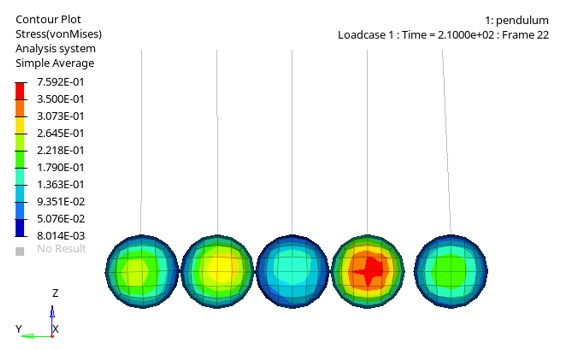

Figure 3. Pendulum Motion
The two extreme pendulums alternate oscillating for half of the time period.

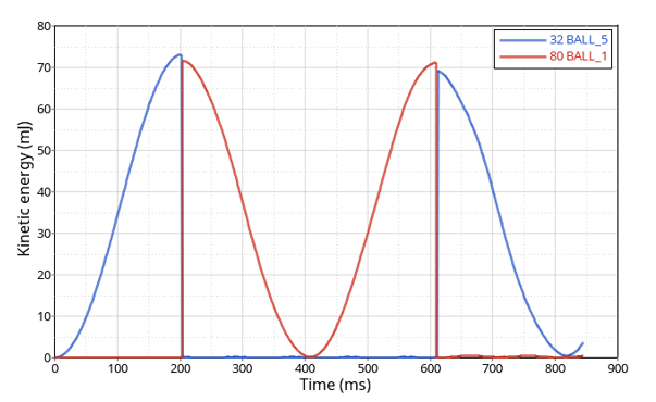

Figure 4. Kinetic Energy Transfer between Ball 5 and Ball 1
In Figure 4, a reduction of kinetic energy between pendulum balls due to contact damping can be observed. The kinetic energy in the system is not entirely maintained due to the energy contact being dissipated during impact. The maximum kinetic energy of Ball 5 just prior to contact with the other balls is 73.135 mJ. This is very close to the analytical energy of 73.136 mJ. When the kinetic energy is transferred from Ball 1 back to Ball 5 at 612.5 ms, the kinetic energy in Ball 5 is 69.187 mJ.

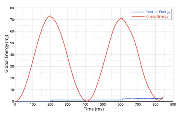

Figure 5. Global Internal and Kinetic Energy
Plotting the global energy of the system in Figure 5 shows that some of the potential energy is converted into internal energy in the system.

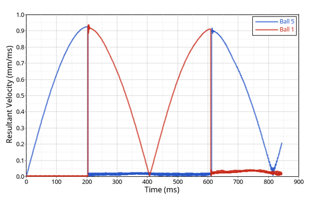

Figure 6. Velocity Curve of Ball 5 and Ball 1
