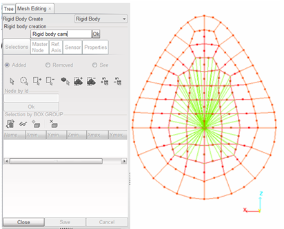

- Rigid bodies: In order to apply a constant angular velocity to the cam, a
rigid body is created over the internal nodes, as shown in Figure 2. The
main node is moved to the camshaft axis. To attach the valve head to the spring, another rigid body is created to distribute the internal spring force over several nodes.

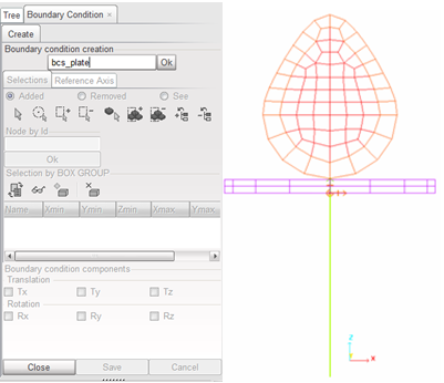

Figure 2. Rigid Body Cam - Boundary conditions:
- Main node of the cam is blocked, except when rotating around Y.
- Main node of the valve is blocked, except when translating around Z.
- One extremity of the spring is fixed to the valve, while the other
is blocked.

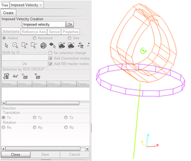

- Imposed velocity: A rotational velocity of 314 rad/s is imposed on the main
node of the rigid body. This velocity is activated by a temporal sensor,
with a short activation delay (Tdelay =0.0002s). This
sensor is necessary to avoid applying the initial and imposed velocities at
the same time.

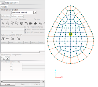

Figure 4. Imposed Velocity - Initial velocity: An initial rotational velocity is applied to all the cam's nodes, including the main node of the rigid body. You must define the origin (center of rotation) and the orientation vector.

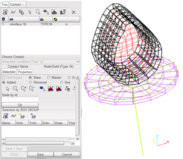

Figure 5. Initial Velocity - Interfaces: The TYPE16 interface simulates a contact between a quadratic
main surface and a group of nodes. In the case of contact between a curved
and a plane surface, the curved surface is defined as the main surface and
the nodes of the plane part are secondary.

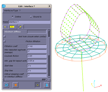

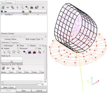

Figure 6. Interface TYPE6The TYPE7 interface works either with Penalty or with Lagrange multipliers. In its basic formulation, the interface simulates contact between two facetisated surfaces. The use of the Lagrange Multipliers method enables to precisely satisfy the kinematic contact without introducing a gap.
Figure 7. Interface TYPE7

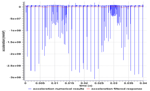

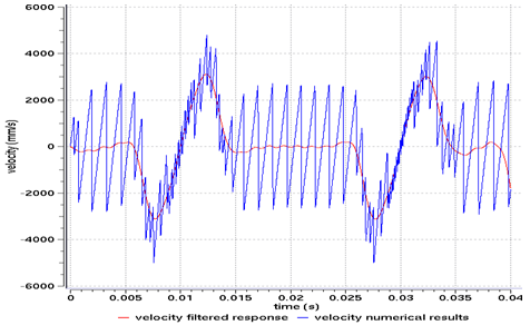

At first, you are interested by the kinematics of the problem. The results obtained for velocity and acceleration at the main node of the rigid body's valve are thus compared.
Figure 11. Vertical Velocity of the Main Node Valve for a TYPE7 Interface, using the Penalty Method
Figure 12. Vertical Acceleration of the Main Node Valve for a TYPE7 Interface, using the Penalty Method
The filtering quality depends on the number of samples which, in this case is the number of points computed by Radioss for each curve. Therefore, a low value for the /TFILE parameter in the Engine file (*_0001.rad) is used to obtain good results, especially for the acceleration curve.

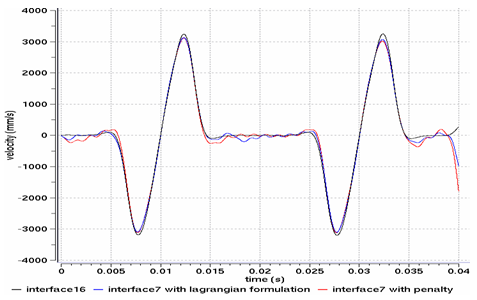

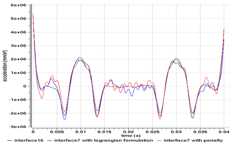

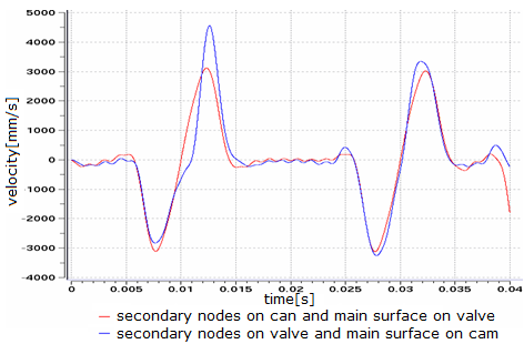

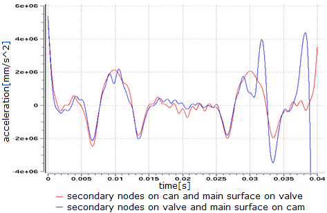

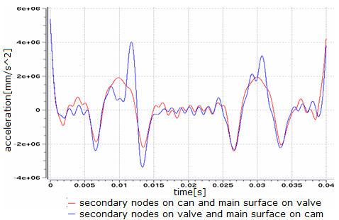

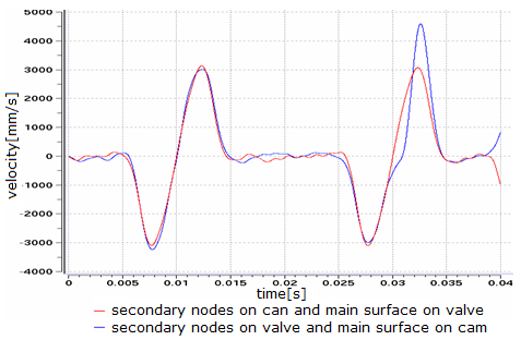

Figure 13 and Figure 14 represent velocity and acceleration curves for a model using a TYPE7 interface with the Penalty method. As for the main and secondary part definition, the results are slightly different.
Figure 13. Vertical Velocity of the Valve's Main Node for a TYPE7 Interface, using the Penalty Method
Figure 14. Vertical Acceleration of the Valve's Main Node for a TYPE7 Interface, using the Penalty Method
Figure 15. Vertical Velocity of the Valve's Main Node for a TYPE7 Interface, using the Lagrange Multipliers Method
Figure 16. Vertical Acceleration of the Valve's Main Node for a TYPE7 Interface, using the Lagrange Multipliers Method
Even if using a TYPE7 interface with the Penalty or the Lagrange Multipliers method good results can be achieved, a quadratic mesh with the TYPE16 interface will enable the reduction of oscillations, due to facetisation.

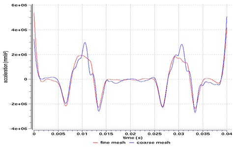

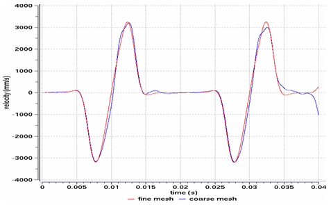

Comparison of Meshes
- Fine Mesh:
- Cam
- 200 external SHEL16 elements, 250 internal BRIC20 elements
- Valve
- 88 SHEL16 elements
- Coarse Mesh:
- Cam
- 40 SHEL16 elements
- Valve
- 12 SHEL16 elements
Figure 19. Vertical Velocity of the Valve's Main Node
Figure 20. Vertical Acceleration of the Valve's Main Node
Although the coarser mesh amplifies the facetisation of the curved surfaced, the mesh density does not influence the results for velocity after filtering. However, the fine mesh provides better results for acceleration, having limited parasite oscillations for each node/surface contact.

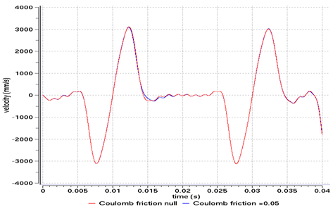

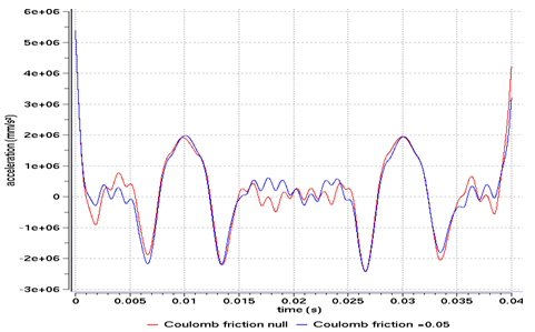

Friction
Figure 21. TYPE7 Interface using Penalty and Friction
Figure 22. Vertical Velocity of the Valve's Main Node for a TYPE7 Interface, using the Penalty Method
Figure 23. Vertical Acceleration of the Valve's Main Node for a TYPE7 Interface, using the Penalty Method
