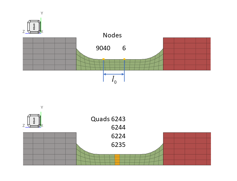

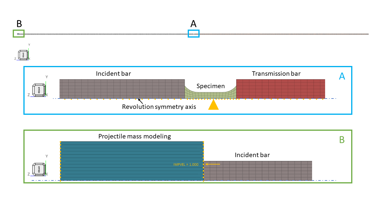

Low extremity nodes of the output bar are fixed in the Z direction. The axisymmetric
condition on the revolutionary symmetry axis requires the blocking of the Y
translation and X rotation.
The projectile is modeled using a steel cylinder with a fixed velocity in the
direction Z. The required strain rate is considered by applying two imposed
velocities, 1.7 ms-1 and 5.8 ms-1 in order to produce strain
rates in the ranges of 80 s-1 and 900 s-1 (low and high
rates).

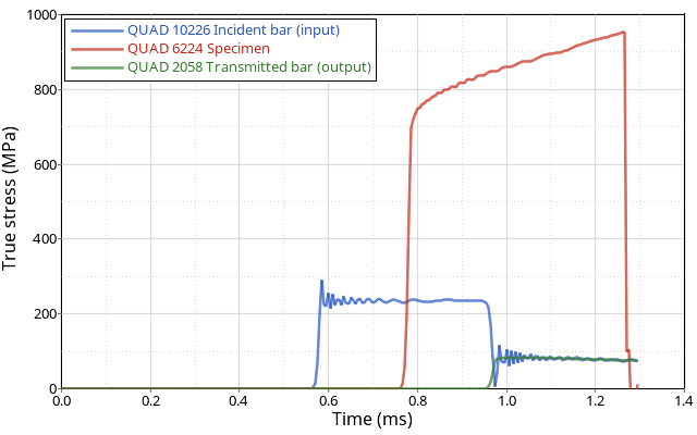

True Stress, True Strain and True Strain Rate Measurement from Time History
Figure 2. Nodes and quads saved for time history
In the experiment, the strain gauge is attached to the specimen. In
simulation, the true strain will be determined from 9040 and 6 nodes’ relative Z
displacements (= 3.83638 mm).
The true stress can be given
using two data sources. The first methodology consists of using the equation
previously presented, based on the assumption of the one-dimensional propagation
of bar-specimen forces. The engineering strain associated with the output stress wave is
obtained from the Z displacement of nodes located on the output bar. The true
plastic strain is extracted from the quads on the specimen, saved in the Time Histories file. True stress can also be
measured directly from the Time History using the average of the Z stress quads
6243, 6244, 6224 and 6235. It should be noted that the section option is not
available for quad elements.

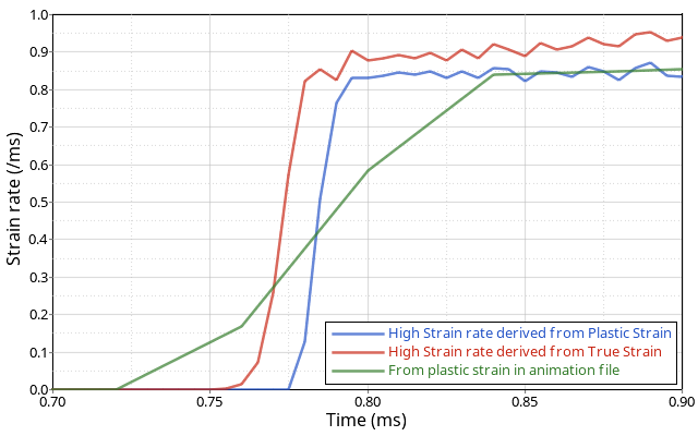

The strain rate can be calculated from either
the true plastic strain of quads saved in /TH/QUAD or
from the true strain .

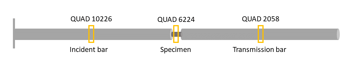

Figure 3 shows the principal test setup, consisting
of:
an incident bar and a
transmission bar of equal length, between which the sample to be tested is
clamped.
a striker is attached
to the outer end of the incident bar. When a steel projectile hits the
striker, a stress pulse is introduced into the incident bar.
Figure 3. Split-Hopkinson pressure bar device

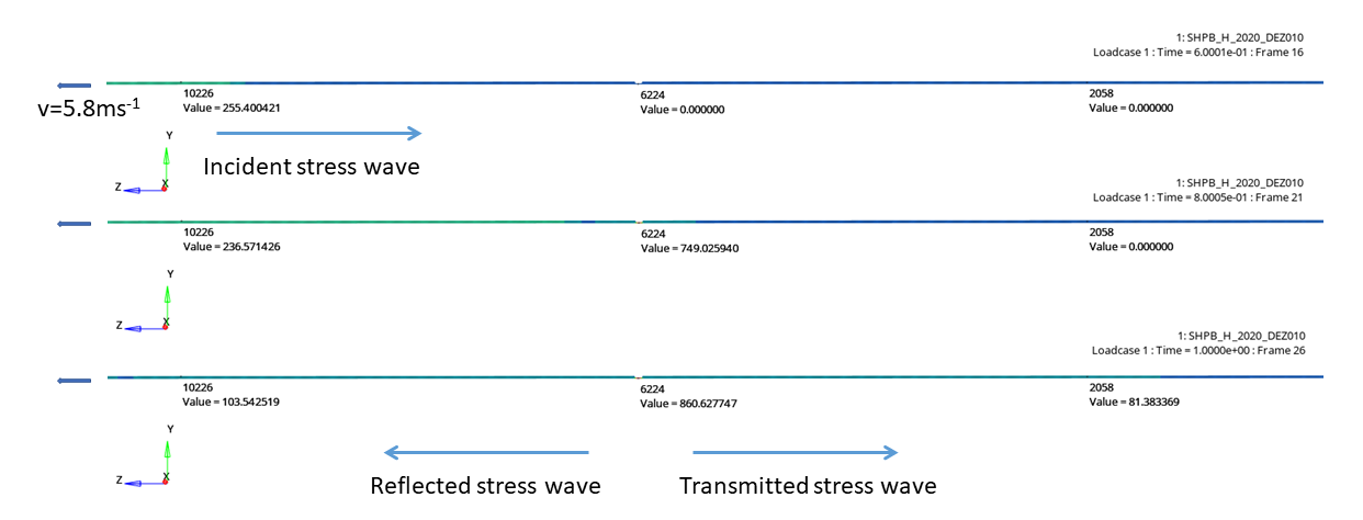

The impact generates a strain (tensile) wave which propagates through (along) the
Incident bar and is detected by strain gauge 1. Part of the wave is reflected, and a
part is transmitted via the specimen’s interface. So, the stress pulse continues
through the specimen and into the transmitted bar. Strain gauges 1 and 2 are
attached to the incident bar and transmission bar to detect the strain wave signal.

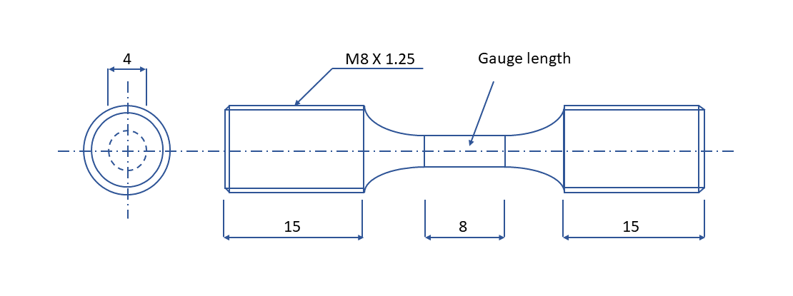

way of the following relation. Figure 4. Specimen geometry and cross-section (dimensions in mm)(1)

Strain Rate Filtering
Because of the dynamic load, strain rates cause high frequency vibrations which are
not physical. Thus, the stress-strain curve may appear noisy. The strain rate
filtering option enables to dampen such oscillations by removing the high frequency
vibrations in order to obtain smooth results. A cut-off frequency for strain rate
filtering Fcut = 30 kHz was used in this example. Refer to RD-E: 1100 Tensile Test for further details.

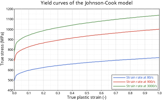

Johnson-Cook Model
The Johnson-Cook model describes the stress in relation to the plastic strain and the strain rate
using the following equation:(6)
Where,
Strain rate.
Reference strain rate.
Plastic strain (true strain).
Yield stress.
Hardening parameter.
Hardening exponent.
Strain rate coefficient.
The two optional inputs, strain rate coefficient and reference strain rate, must be defined for
each material in /MAT/LAW2 in order to take account of the strain
rate effect on stress, that is the increase in stress when increasing the strain
rate. The constants , and define the shape of the strain-stress curve.
In the documents entitled CRAHVI, G4RD-CT-2000-00395, D.1.1.1, Material Tests –
Tensile properties of Aluminum Alloys 7010T7651 and AU4G Over a
Range of Strain Rates, the behavior of the 7010 aluminum alloy can be
described according to the relations:
Strain rates below 80 s-1
Strain rates exceeding 80 s-1 up to 3000 s-1
Figure 6. Yield curve of the Johnson-Cook model:

Model Method
Considering the geometry’s revolution symmetry the material and the kinematic
conditions, an axisymmetric model is used (N2D3D =
1 in /ANALY set up in the Starter
file). Y is the radial direction and Z is the axis of revolution.
The mesh is made of 12054 2D solid elements (quads). The quad dimension is about 2
mm. Figure 7. Axisymmetrical model mesh. with imposed velocities on the top of the input bar

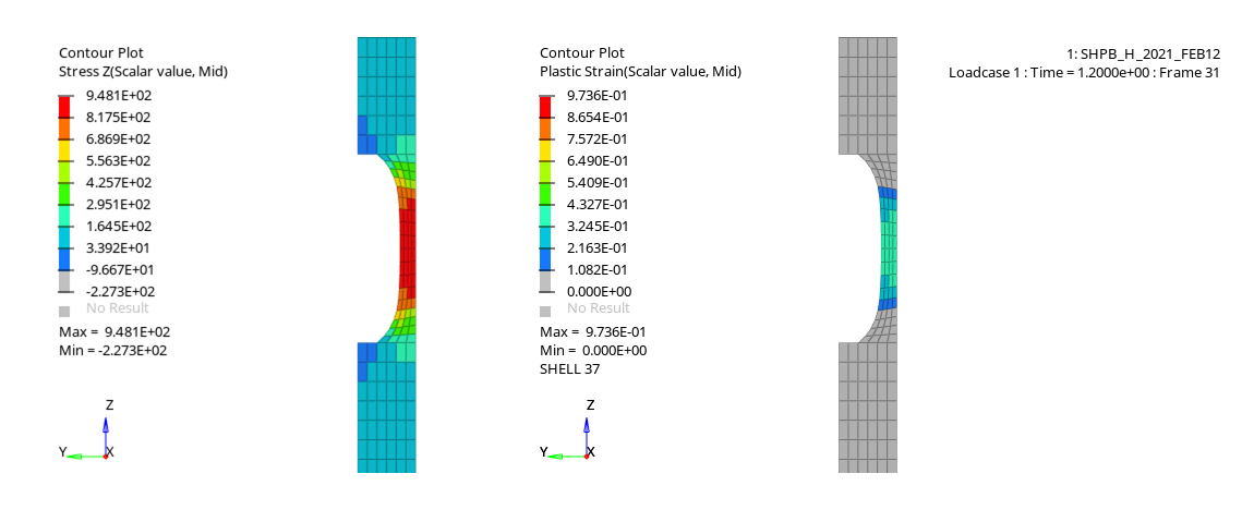

Results

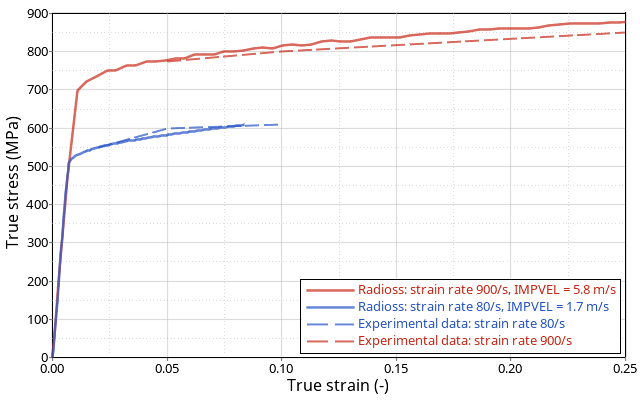

The purpose of the test is to obtain results at high deformation rates. In this model
the Johnson-Cook type material law is used. The increase of stress is expected to be

Experimental Data
Experimental results show that the variation of the true tensile flow stress compared
with the true strain is approximately equivalent to a strain rate between 80
s-1 and 100 s-1. The reference strain, in the Johnson-Cook model is set to 0.08
ms-1 (correspond to 80 s-1, which represents the
quasi-static deformation rate. At higher deformation rates, the true flow stress
increases significantly with increasing strain rates. The 7010 aluminum alloy
exhibits an increase in the flow stress by a typical value of 30% at high strain
rates (900 s-1 – 3000 s-1) compared to the quasi-static
value.

Figure 9 shows the variation of true stress in time in relation to the
wave propagation along the bars. Stresses are evaluated on the input bar, the
specimen and the transmission bar. Figure 9. Stress measurement localizations Figure 10. Stress waves in the input bar, the output bar and the specimen. (imposed velocities = 5.8 ms-1)
The stress-time curve shows the incident, reflected and transmitted
signals. Figure 11. SHPB of the motion in time of the tensile pulse Figure 12. von Mises stress wave propagation along bars. (imposed velocities = 5.8 ms-1)
The speed of wave, along the bars is calculated using the
relation:(7)
Where,
Young's modulus.
Density of the bars.
The time step element is controlled by the smallest element located in
the specimen. It is set at 5x10-5 ms. The stress wave thus reaches the
specimen in 0.77 ms and travels 0.26 mm along the bar for each time step. Obviously,
it remains lower than the element length of the smallest dimension (0.88
mm).
An imposed velocity of 5.8 ms-1 produces a strain rate in the
specimen of approximately 900 s-1, while a strain rate of approximately
80 s-1 is achieved using an imposed velocity of 1.7 ms-1. A
simulation is performed for each velocity value.

Figure 13 shows the true stress and true strain as a function of the
strain rate. Figure 13. Variation of true stress with true strain for high and medium strain
rates
At a high strain rate (900/s), an increase in the flow stress is
observed, being approximately 30% higher than the stress obtained for a low strain
rate (80/s). The Johnson-Cook model used provides precise results compared with the
experimental data. Figure 14. Stress Z and plastic strain on specimen at 1.2 ms
The true stresses determined from both methodologies are shown
side-by-side. This validates the analysis based on a transmitted wave. Typical
curves for a model having imposed velocities equal to 5.8 ms-1 (Figure 15 and Figure 16). Figure 15. True stress comparison in the specimen Figure 16. True strain rate in the specimen
Either data sources used to evaluate the strain rate give similar
results.
