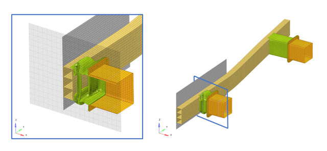

The target of the cut methodology is to study one area of the model by applying the deformation of the full model to a smaller model.
Figure 1. Full Model and Sub-Model

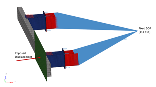

Figure 2. Problem Description
Units: mm, ms, kg, N, GPa

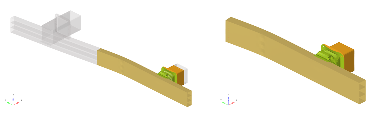

Figure 3. Full Model Results with Suggested Cut Location to Create the Sub-Model
In order to focus on the crash box area just behind rigid plate, the sub-model (blue highlighted area in Figure 3) is cut from the full model. To have the same behavior as the sub-model and the full model, the force and displacement on the boundary of the selected are needed. Using /SECT, it is possible to save and read section force or displacement.

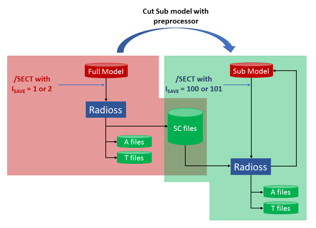

The node groups and element groups in the section should be the same in the full model and sub-model to ensure consistency between the forces. It is also possible to use HyperMesh to create the /SECT in the full model and create the sub-model by deleting elements from the full model.
Figure 4. Cut Methodology in Radioss

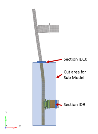

Figure 5. Deformation Overlay of the Full Model and Sub-Model
The cross-section force in the crush box is very similar between the two simulations. If the sub-model results are very different than the full model, more section output results can be saved in the SC file by reducing the /SECT . Alternatively, the location of the sections could be modified to include a larger area from the full model that influence the deformation of the sub-model.
