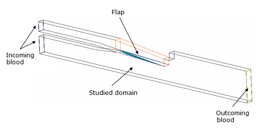

A simplified heart valve is modeled. The valve opens under the pressure of the incoming blood flow. As the opening process of the valve is taken into account, the problem is transient.
Additionally, fluid-structure interaction must be taken into account, as the flap deforms under the pressure of the blood.
Figure 2. Problem Definition

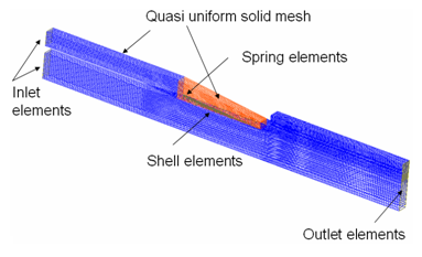

A quasi-uniform solid mesh is used for domain discretization. One element through the thickness with a fine enough mesh along the axis is used.
Shell elements are used to model the flap. The flap is clamped on one side and its nodes are attached by the springs to the clamp. One row of meshes are created at each extremity to define inlet and outlet.
The problem is incompressible; therefore, in order to increase the time step, the speed of the sound in the fluid has been arbitrarily reduced to 50 m/s.
Figure 3. Mesh of the Model

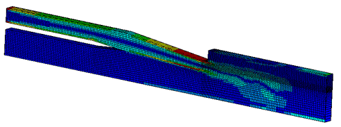

Results

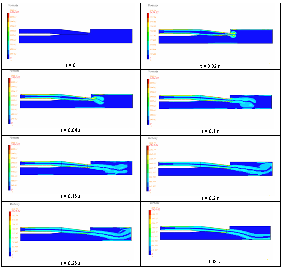

Figure 4. Vorticity Distribution in Time and in Space

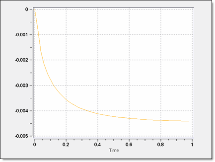

Figure 5. Vertical Displacement of the Free Extremity (node 23360) of the Flap in Meter

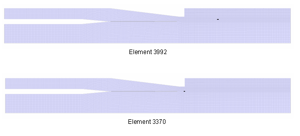

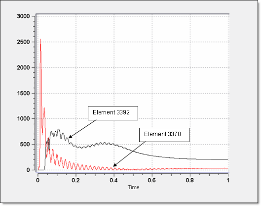

Figure 6. Pressure Stabilization for Elements 3370 and 3992 in Pa
Figure 7. Position of Elements 3992 and 3370

This example demonstrates Radioss capabilities to simulate transient Fluid-Structure-Interactions. The use of the ALE formulation attached to a Lagrangian mesh is described. Some elementary explanations to Radioss ALE/CFD terminology are mentioned.
