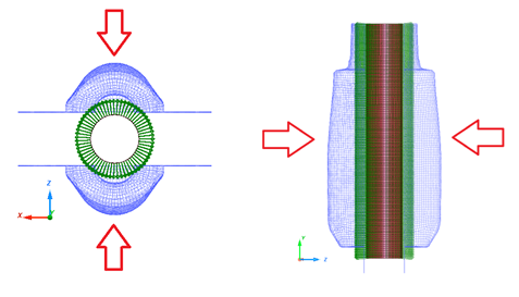

Using rigid body, two molds have been fixed in all direction of rotation and translations of y-direction and x-direction. They are only free in z-direction (translation).
- Impose displacement (/IMPDISP)
Two molds are moved in opposite directions with imposed displacement.

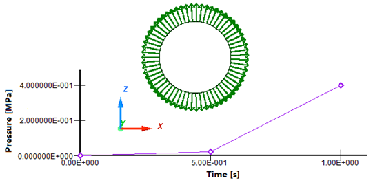

- Pressure Load (/PLOAD)The air pressure on the plastic parison is modeled using pressure load /PLOAD from inside towards outside.
Figure 2. Pressure Load on Plastic Parison

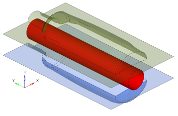

Model Description
Figure 3. Problem Description for Blow Molding

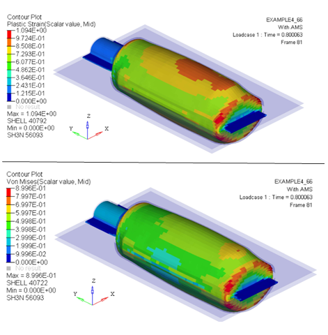

Figure 4. Plastic Strain and von Mises Stress on Plastic Parison

Using the AMS technique, CPU time is reduced by a factor of approximately 3, in this case.

It shows at time 0.4s for the same speed up factor with AMS you get more accurate results compare with no mass scaling test than with node mass scaling.
