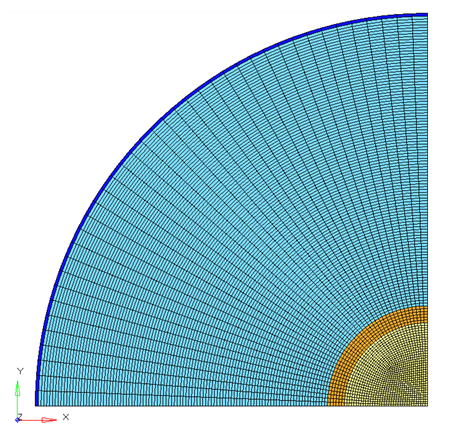

A 3D mesh is made of brick elements. The element size for the copper cylinder is approximately of 0.035 cm x 0.035 cm x 0.035 cm.
The mesh is dragged along the z direction (z = 30.5 cm). It is important to have no discontinuity in element volume in order to ensure a good propagation of detonation wave and shock wave.
Figure 3. Model mesh

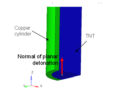

Figure 5. Planar detonation
- Isolid is set to 0 for TNT and copper solid properties.

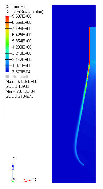

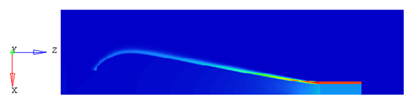

Figure 6. Density distributed in Copper and TNT at time = 33s

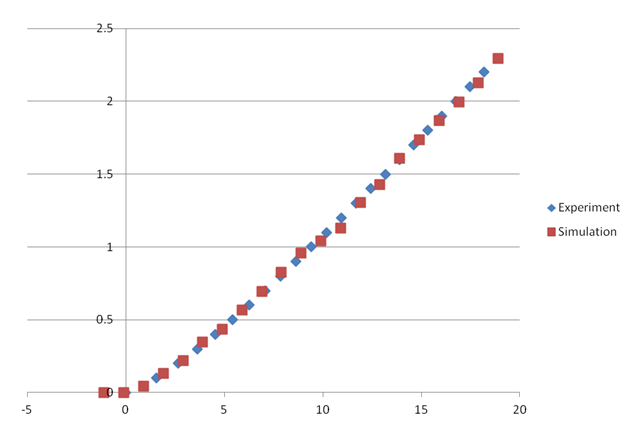

Figure 7. Comparison between experimental results and simulation results
Conclusion
Good correlation between experimental and simulation results. A thinner meshing could improve the correlation between simulation and experimental curves.
