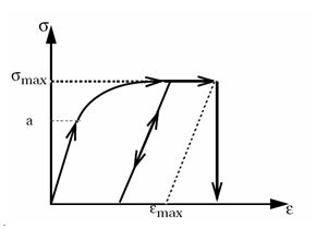

- In this model, the material
behaves as a linear-elastic material when the equivalent stress is lower than the plastic
yield stress. For higher stress values, the material behavior is plastic and the stress is
calculated as:
(1) Where,(2) Where,- Plastic strain
- Strain rate
- T
- Temperature
- Tr
- Reference temperature
- Tmelt
- Melting temperature
When /HEAT/MAT (with Iform = 1) references this material model, the values of Tr and Tmelt defined in this card will be overwritten by the corresponding T0 and Tmelt defined in /HEAT/MAT.
When the temperature is not initialized using /HEAT/MAT or /INITEMP, the reference temperature (Tr) is also the initial temperature.
Figure 1. - The plastic yield stress should always be greater than zero. To model pure elastic behavior, the plastic yield stress will be set to 1030.
- When reaches the value of (for tension, compression or shear), in one integration point, the deviatoric stress of the corresponding integration point is permanently set to 0, however, the solid element is not deleted.
- The plastic hardening exponent, n, must be less than or equal to 1.
- To eliminate the effect of the strain rate, either set the value of c equal to 0 or set the reference strain rate ( ) equal to 1030. There is no effect of strain rate when is less than .
