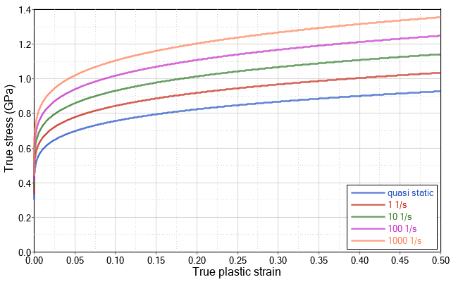

The Johnson-Cook plasticity model (/MAT/LAW2) is used to consider the strain rate effect on the elasto-plastic.
- Strain rate
- Reference strain rate
- Strain rate coefficient
The term scales the stress strain curve for strain rates that are greater than the reference strain rate.
For strain rates less than the reference strain rate, there is no scaling. In this example, there is no test data, so approximate values of = 1x10-4 ms-1 and = 0.05 are used to demonstrate the behavior. When the strain rate behavior of the material is not known, the strain rate coefficient is typically defined as =0 and; thus, there is no strain rate effect for the material.
Figure 1. True Stress versus True Plastic Strain at Different Strain Rates for the Johnson-Cook Material Model

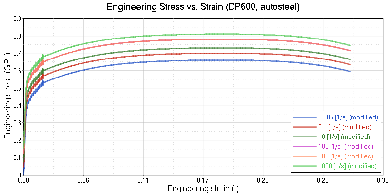

/MAT/LAW36
Figure 2. Material Data of Engineering Stress versus Strain for Different Strain Rates. (Steel DP600, original data from autosteel)
Figure 3. Original and Modified Engineering Stress versus Strain Curves for Different Strain Rates. (Steel DP600, autosteel)
Figure 4. Modified Engineering Stress Strain Curves for Different Strain Rates
Figure 5. True Stress versus True Plastic Strain Curves for Different Strain Rates
