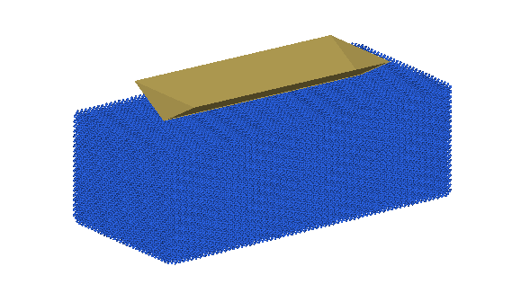

The problem consists of a simple object falling into water simulating the ditching of a helicopter.
Units: mm, ms, KN, GPa, kg.

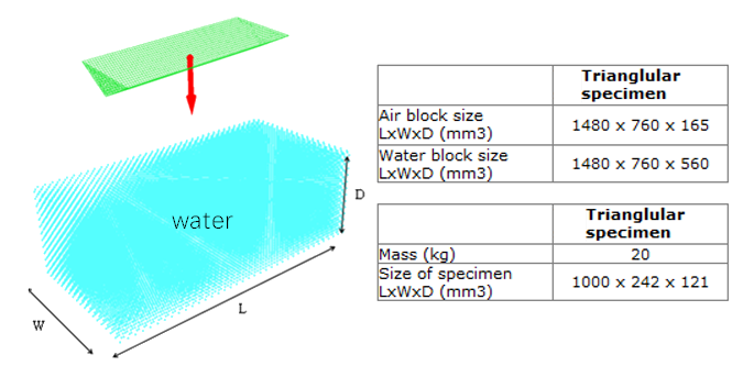

The impacting prism is modeled using shell elements with an average mesh size of 15 mm x 15 mm. To shorten the computation, it is made rigid with an accelerometer on the main node of the rigid body. Additional mass is added to the main node of the rigid body, so the total mass of the prism is 27 kg.
The water is modeled using SPH particles with a face-centered cubic mesh and smoothing length "ho" equal to 21 mm. Each SPH weighs m=2.61 g. The SPH particle mesh can be generated in HyperWorks using the SPH panel with a face-centered cubic pitch=15, and a material density of 1.0e-6 . HyperWorks will then automatically create SPH property /PROP/SPH. This results in 222005 SPH elements. The size of the water is adapted to the shape of the object to reduce the model’s size and the simulation’s CPU time. For an SPH analysis, air is not typically modeled.

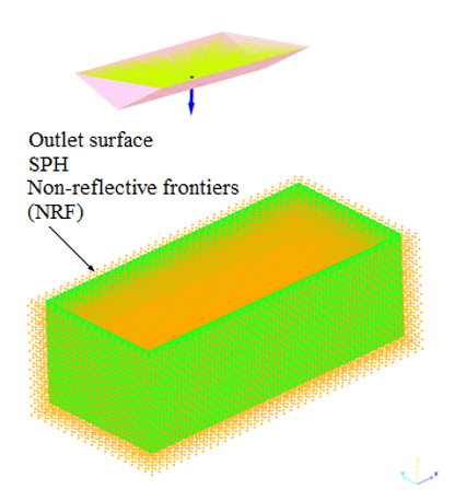

Figure 3. SPH Outlet Surface Non-reflective Frontiers (NRF) (green)

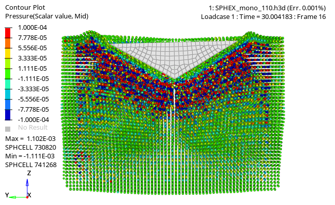

The SPH particles are supported as MASS elements in HyperView. Their display type and size can be set in HyperView by using . In this example, the animation results are directly output to an h3d file using the /H3D option. The pressure in the water can be plotted.
Figure 4. Pressure results from a section cut
