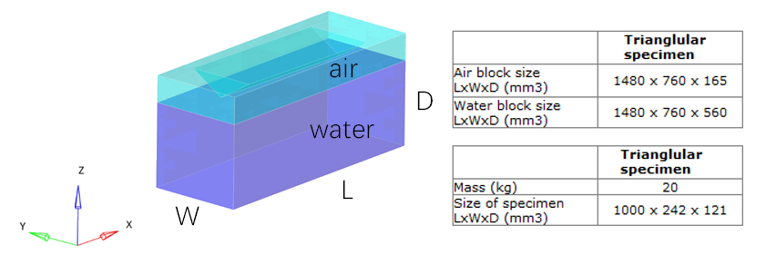

The problem consists of a simple object falling into water simulating the ditching of a helicopter.
Units: mm, ms, KN, GPa, kg
The impact of the triangular prism object on the water is performed and the results are compared qualitatively to analytical results from 2 and also using the experimental data obtained from the Politechnico di Milano. 1
Figure 2. Problem Data

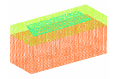

The impacting prism is modeled using shell elements with an average mesh size of 15 mm x 15 mm. To shorten the computation, it is made rigid with an accelerometer on the main node of the rigid body.
The water is modeled using solid elements consisting of a 15x15x15 mm mesh. The solid element property, /PROP/ TYPE14 (SOLID) is used with qa=qb =1e-20 which is recommended for classical subsonic fluid simulation.

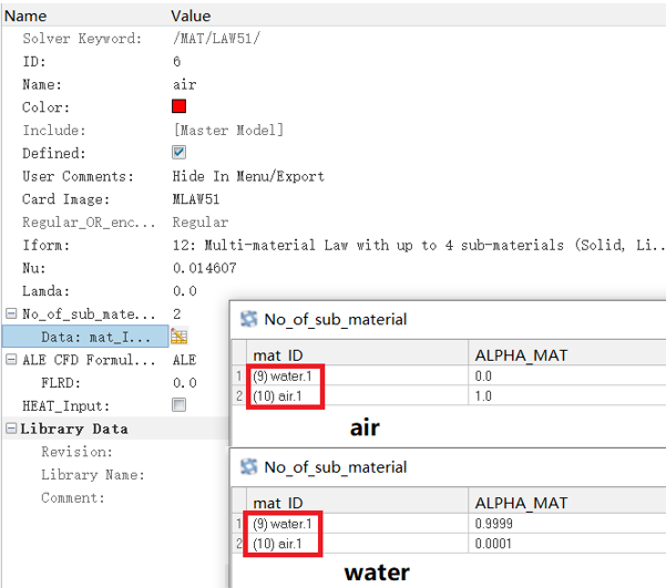

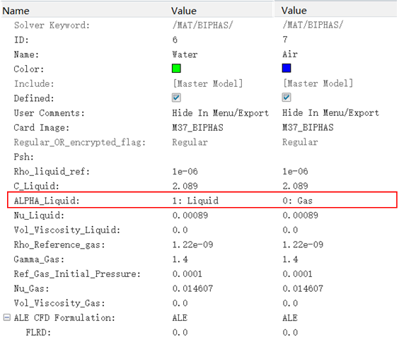

The material law for air and water can use either the BIPHAS law (/MAT/LAW37) or /MAT/LAW51. In older versions of Radioss, /MAT/LAW37 was used. Now /MAT/LAW51 is the recommended best practice and only the input file for the model using /MAT/LAW51 is included as an example. A comparison between results using LAW37 and LAW51 is shown.
Figure 3. /MAT/LAW37 material properties

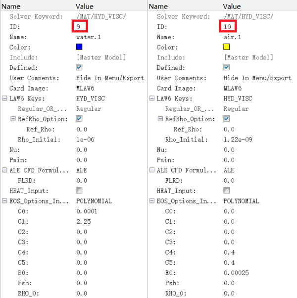

When using LAW51 with Iform=12 the air and water can be defined using a /MAT/LAW6 sub-material.
Figure 4. /MAT/HYD_VISC (LAW6) material properties
Figure 5. /MAT/LAW51 material properties
Boundary Setup
An initial velocity and gravity are applied to the prism in the Z direction.
- Z translation component fixed for lower and upper faces
- Y translation component fixed for lateral faces normal to Y
- X translation component fixed for lateral faces normal to X
Figure 6. Boundary mesh treatment

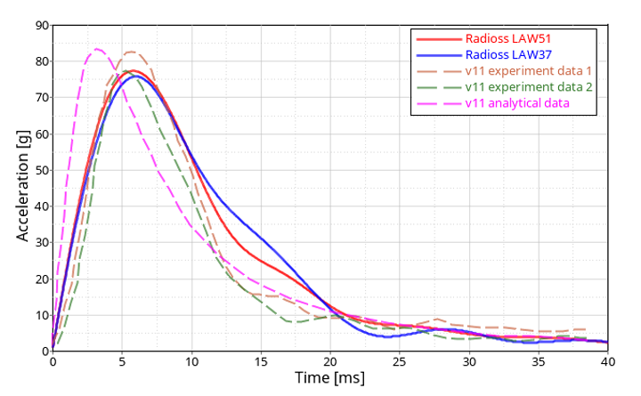

Results using material LAW37 and LAW51 at 11 m/s are compared.
Figure 7. Density results for LAW51 and LAW37
Figure 8. Acceleration results for 11 m/s for simulation, theoretical solution, and experimental test
The ALE method results in a maximum acceleration of 77.3 g for LAW51 and 75.8 g for LAW37. However, the Von Karman theoretical solution delivers 83.5 g. The maximum value from the test is between 82.8 g and 77.5 g.
In general, the ALE results match the analytical and experiment curve, especially at the duration for acceleration beyond 40 g. Using material LAW51 is recommended because it results in a more discrete boundary at the fluid-structure interface.
