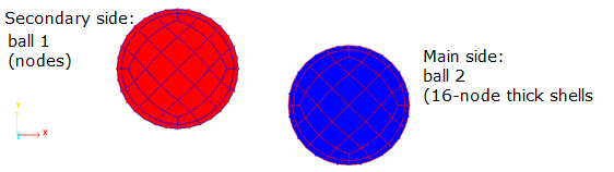

The ball/ball and balls/table contact is modeled using the TYPE16 interface
(secondary nodes/main 16-node thick shells contact). The interface defining the
ball/ball contact is shown in Figure 4.

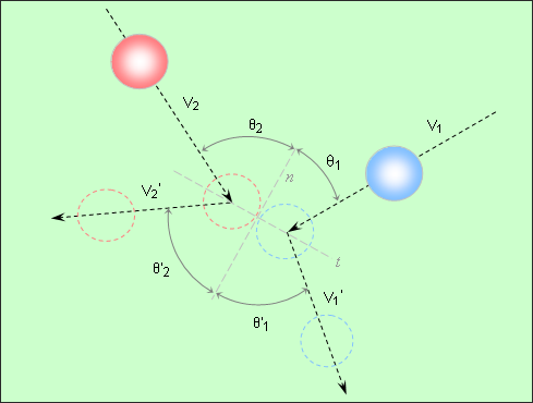

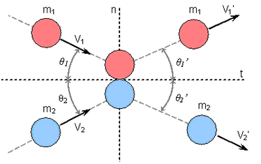

Analytical Solution
Take two balls, 1 and 2 from masses and , moving in the same plane and approaching each other
on a collision course using velocities and , as shown in Figure 5.
Velocities are projected onto the local axes and . To obtain the velocities and their direction after
impact, the momentum conservation law is recorded for the two balls:(1)
Or(2)

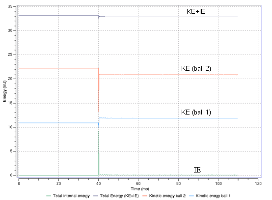

The shock is presumed elastic and without friction. Maintaining the translational
kinetic energy is respected as there is no rotational energy:(3)
Such equality implies that the recovering capacity of the two balls corresponds to
their tendency to deform.
This condition equals one of the elastic impacts, with no energy loss. Maintaining
the system's energy gives:(4)
This relation means that the normal component of the relative velocity changes into
its opposite during the elastic shock (coefficient of restitution value e is equal
to the unit).

As the balls do not suffer from velocity change in the t-direction, maintaining the
tangential component of each sphere's velocity provides:(7)
The norms of velocities after shock result from the following
relations.(8)(9)
In this example, balls have the same mass: m1 = m2.
Therefore, and .
The norms of the velocities are given using the following relations, depending on the
initial velocities and angles. Used to determine the analytical solutions (angles
and velocities after collision):(10)(11)
By recording the projection of the velocities, directions after shock can be
evaluated using relation. Used to determine the analytical solutions (angles and
velocities after collision):(12)(13)

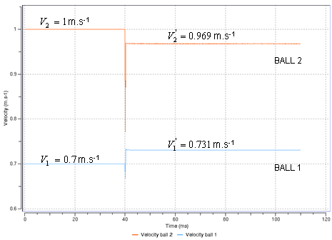

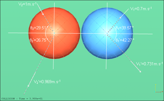

Figure 6 shows the trajectories of the balls' center point obtained using
numerical simulation before and after collision.
For given initial values of , , 1 and 2, simulation results are reported in Table 1.
Table 1. Comparison of Results for After Collision
Numerical Results
Analytical Solution
1'
42.27°
44.72°
2'
26.75°
26.48°
V 1'
0.731 m/s
.731 m/s
V 2'
0.969 m/s
0.977 m/s
