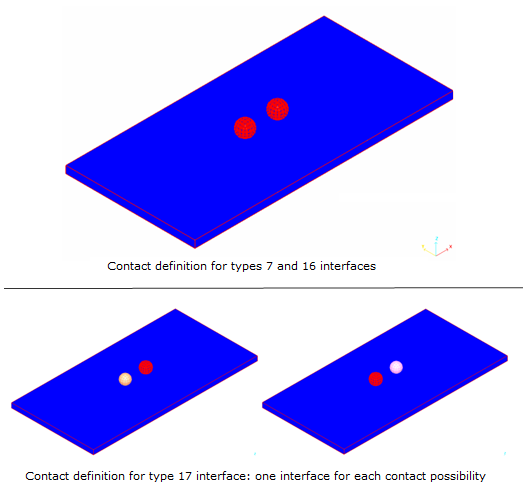

Six interfaces are used to model the contacts (ball/ball and balls/table):
Interfaces Used in the Problems
TYPE16 (Lagrange Multipliers) tied or sliding
Secondary nodes/main solids contact
TYPE17 (Lagrange Multipliers) tied or sliding
Secondary 16-node shells/main 16-node shells contact
TYPE7 (Lagrange Multipliers)
Secondary nodes/main surface contact
TYPE7 (Penalty) sliding
Model Method
The TYPE16 interface defines contact between a group of nodes (secondary) and a curved surface of quadratic elements (main part). The TYPE17 interface is used for modeling a surface-to-surface contact. For both interfaces, the Lagrange Multipliers method is used to apply the contact conditions; gaps are not required. Contact between the balls and the table is set as tied or sliding. Contact between the balls themselves is always considered as sliding. The TYPE7 interface enables the simulation of the most general contact types occurring between a main surface and a set of secondary nodes. The Coulomb friction between surfaces is not modeled here (sliding contact) and the gap is fixed at 0.1 mm. The other parameters are set to default values.
The TYPE7 interface with the Penalty method is not available with 16-node thick shell elements. Thus, brick elements replace the 16-nodes shells in this case (check in the input file).
Contact modeling between balls (always sliding).

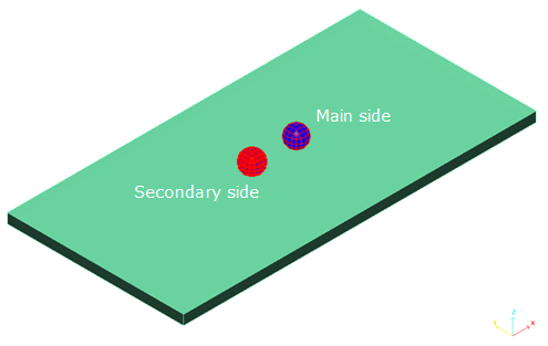

rad_ex_fig_9-19
Figure 1. Definition of Secondary and Main Sides for Contact
The symmetrical interface definition is not recommended when using the Lagrange Multipliers method (TYPE16, TYPE17 and TYPE7-Lag). The problem using the interface with the Penalty method uses two interfaces to model the symmetrical impact.
rad_ex_fig_9-20
Figure 2. Symmetrical Configuration of the TYPE7 Interface using the Penalty Method

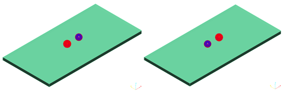

Contact between the balls and the table (sliding or tied depending on the problem):
rad_ex_fig_9-21
Figure 3. Definition of Secondary and Main Objects for Balls/Table Contacts
