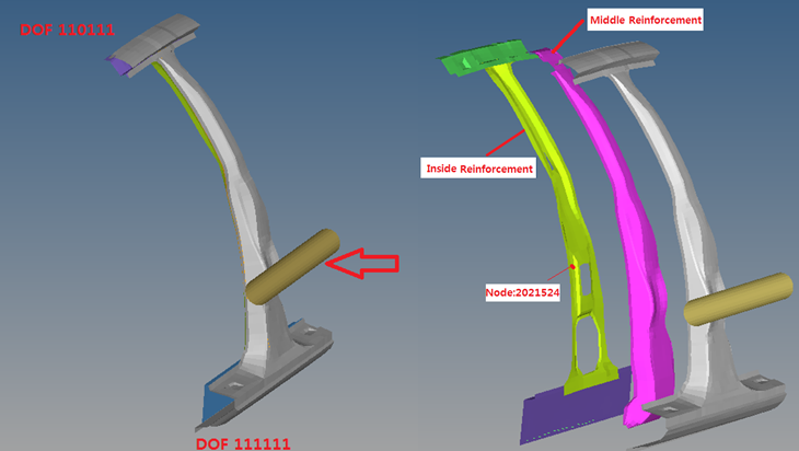

This example defines a crash test on B-Pillar. The optimization objective is to minimize the mass of the B-Pillar by changing the shell thickness. The intrusion, which is defined by the optimization constraint is required to not be larger than the original model, to keep the passenger safe.

- Objective: Minimize mass
- Constraint: Maximum displacement of node 2021524 in Y direction (inside
reinforcement) < 19.7 [mm]
Figure 2. Problem Description - Design variables:
- Shell thickness of the middle reinforcement - allowable range [0.5mm, 3.0mm]
- Shell thickness of the inside reinforcement - allowable range [0.5mm, 3.0mm]

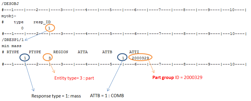

Optimization Objective
/DESOBJ is used to define optimization objective. In this example, it defines the minimal response #1.
Figure 4. Optimization Objective Setup in Radioss Optimization

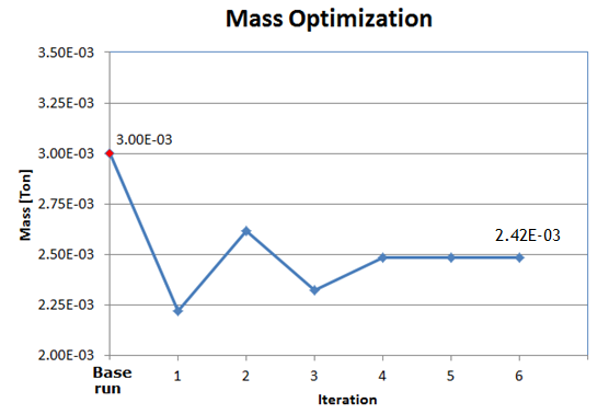

Figure 8. Optimized Results in Each Iterations in *eslout File
In the original model, the mass of the two parts is 3.0011e-3[Ton] and the optimized mass for these two parts is 2.4158e-3[Ton]. The mass is reduced by approximately 19.5%.
The thickness of part #2000327 is 1.328mm and the optimized thickness is 0.5539mm. The thickness is reduced.
Figure 9. Optimized Results of Shell Thickness of Two Reinforcement Parts
Figure 10. Optimized Results of Total Mass of Two Reinforcement Parts
In the last iteration, the mass was reduced to 2.4158e-3[Ton]. This new design still meets the constraint (< 19.7[mm]), defined in /DCONSTR.
