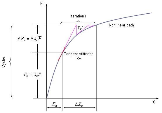

Figure 1. Newton-Raphson Resolution in the Case of Load Control Technique
The modified Newton-Raphson method is based on maintaining the tangent matrix for all iterations and can be combined with the line search acceleration technique for accelerating convergence.

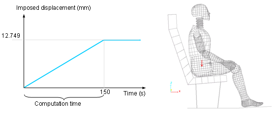

Positioning Using an Imposed Displacement

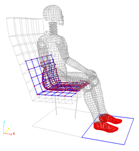

Figure 4. Nonlinear Contact Modeling with Self-impacting TYPE7 Interface
Figure 5. Imposed Displacement Along the Z-axis as a Monotonous Increasing Time Function
- Implicit type
- Static nonlinear
- Nonlinear solver
- Modified Newton
- Stop criteria
- Relative residual in force
- Tolerance
- 0.01
- Update of stiffness matrix
- 5 iterations maximum
- Time step control method
- Arc-length method and "line-search"
- Initial time step
- 5 s
- Minimum time step
- 0.01 s
- Maximum time step
- no
- Desired convergence iteration number
- 6
- Maximum convergence iteration number
- 20
- Decreasing time step factor
- 0.8
- Maximum increasing time step scale factor
- 1.1
- Arc-length
- Automatic computation
- Spring-back option
- no
Implicit parameters are set in the Engine file with the options beginning with /IMPL.
- /IMPL/PRINT/NONLIN/-1
- Printout frequency for nonlinear iteration
- /IMPL/SOLVER/3 5 0 3 0.0
- Solver method (solve Ax=b)
- /IMPL/NONLIN 5 2 0.01
- Static nonlinear computation
- /IMPL/DTINI 1
- Initial time step determines the initial loading increment
- /IMPL/DT/STOP 1e-3 0
- Min-Max values for time step
- /IMPL/DT/2 6.0 20 0.8 1.1
- Time step control metho 2 - Arc-length+Line-search will be used with this method to accelerate and control convergence
Due to the contact problem, the tolerance value (Tol) is set to 10-2 (default = 10-3).

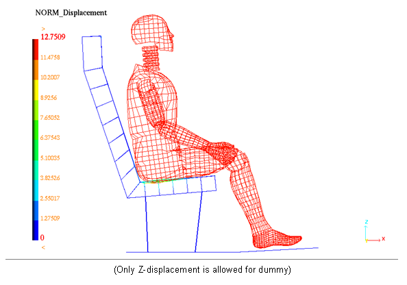

Results
The last animation corresponds to the static solution.
Figure 6. Nonlinear Static Implicit Solution of the Imposed Displacement
| Explicit Solver - /DYREL | Implicit Solver - Nonlinear | |
| Normalized CPU | 1.26 | 1 |
| Number of cycles (normalized) | 56704 (1718) | 33 (1) |

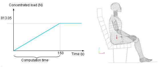

Positioning Using a Concentrated Load
Figure 7. Concentrated Load Along the Z-axis as a Monotonous Increasing Time Function

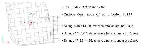

Figure 8. Springs TYPE8 Defined for Removing Rigid Body Modes during Implicit Computation
- Linear elastic behavior
- Mass = 1g
- Inertia = 0.001
- Translational stiffness: TX = 1 N/mm
TY = 1 N/mm
TZ = 1 N/mm
- Rotational stiffness: RX = 100 Mg.mm2/(s2.rad)
RY = 100 Mg.mm2/(s2.rad)
RZ = 100 Mg.mm2/(s2.rad)
Implicit options are the same as the previous implicit problem; except for the initial time step is set to: 2s.
Results

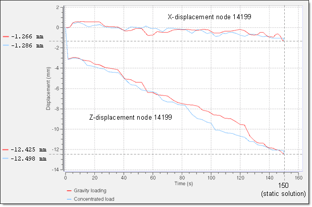

| Normalized CPU | 3.07 | 1 |
| Number of cycles (normalized) | 56704 (1090) | 52 (1) |
| Z - displacement (main node dummy) | -12.75 mm | -12.49 mm |
Positioning Using Gravity Loading

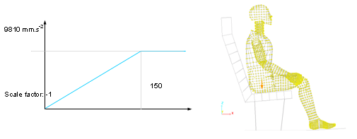

Figure 9. Gravity Loading as a Monotonous Increasing Time Function
Implicit options are the same as the previous implicit problem (initial time step is set to: 2s).
Results
| Explicit solver - /DYREL | Implicit solver - Nonlinear | |
| Normalized CPU | 2.53 | 1 |
| Z - displacement (main node dummy) | -12.75 mm | -12.42 mm |

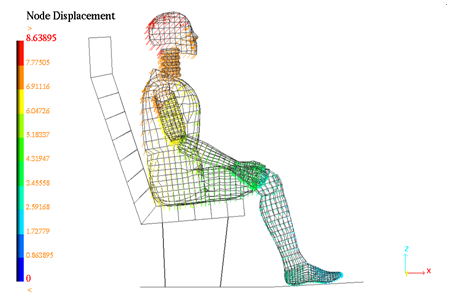

Figure 10. Convergence results of the X- and Z-displacement of main node 14199 (rigid body dummy). for the implicit models using gravity loading and concentrated load

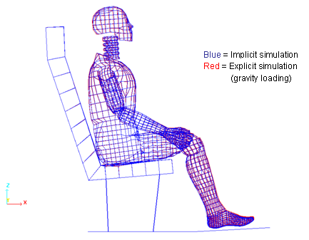

Figure 11. Final dummy position obtained using IMPLICIT (model using gravity loading) . (and EXPLICIT model with gravity loading and kinetic relaxation)
