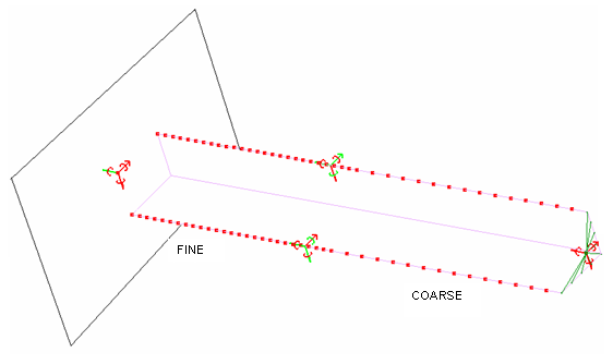

The structure's self-impact is modeled using a TYPE7 interface on the full structure. The interface main surface is defined using the complete model. The secondary nodes group is defined using the main surface.
On top of the beam, the possible edge-to-edge impacts are dealt with using a TYPE11 self-impacting interface. The edges use the main surface of the TYPE 7 interface as the input surface. - Global plasticity, iterative plasticity, and variable thickness
- BT_TYPE1-3-4, QEPH, BATOZ, DKT18 and C0 formulation
- Boundary conditions (/BCS)
Take into account the symmetry, all nodes in the Y-Z plan are fixed in a Y translation and an X and Z rotation. One quarter of the structure is modeled.
- Rigid wall (/RWALL)
The impactor is modeled by a sliding rigid wall using a fixed velocity (13.3 m/s) in the Z-direction and fixed for other translations and rotations.
- Imposed velocity (/IMPVEL)
- Rigid body (/RBODY)
The lower (fixed) end is modeled using a rigid body connecting all lower nodes (Z = 0.0). The rigid body is completely fixed in translations and rotations.

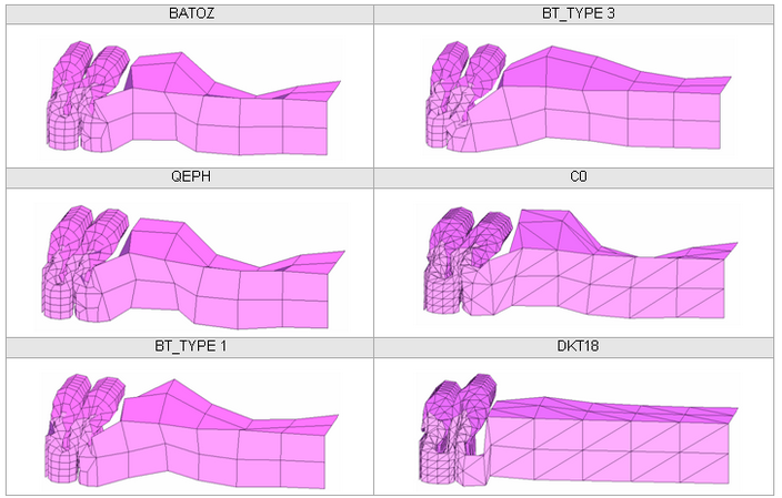

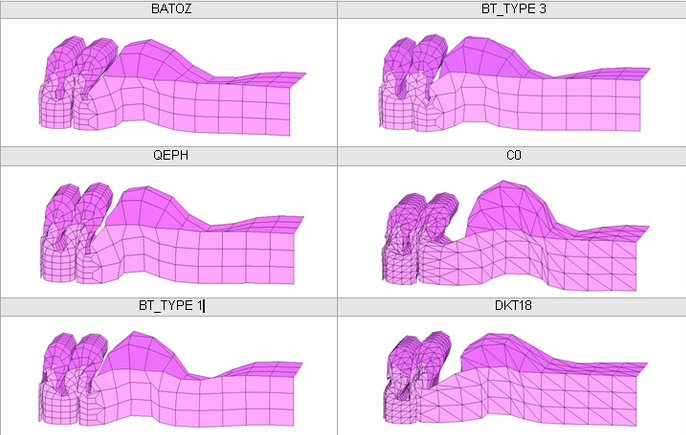

The layout of the elements is shown in Figure 3.
- Element formulation:
- BT_TYPE1
- BT_TYPE3
- QEPH
- BATOZ
- C0
- DKT18

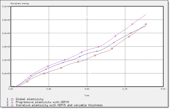

- Plasticity:
- Global plasticity
- Progressive plasticity with five integration points
- Iterative plasticity with five integration points and variable thickness

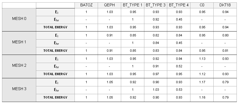

Results

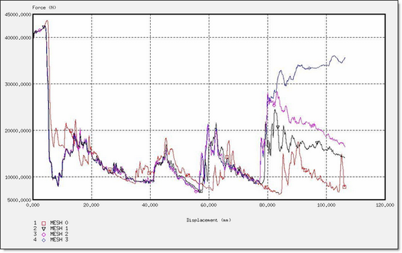

- Role and influence of the mesh for a given type of element formulation

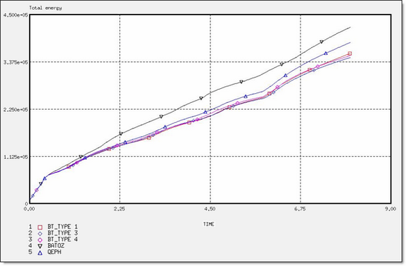

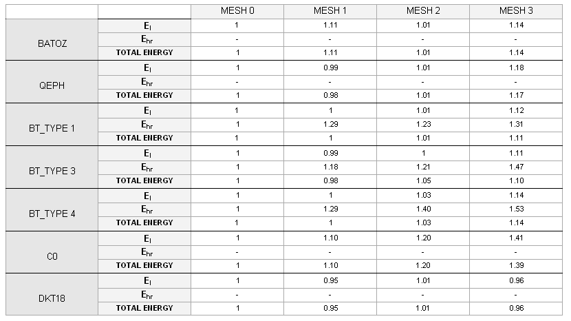

- Shell element formulations for a given mesh

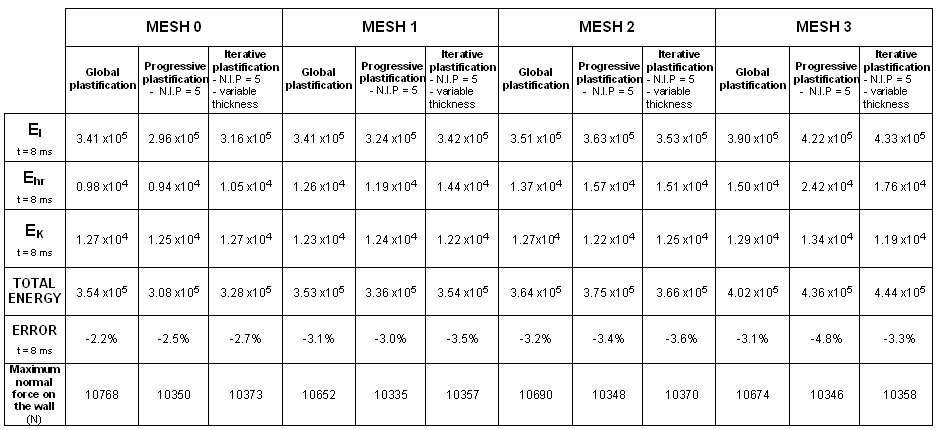

- Plasticity options for a given mesh and element formulation

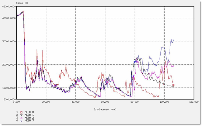

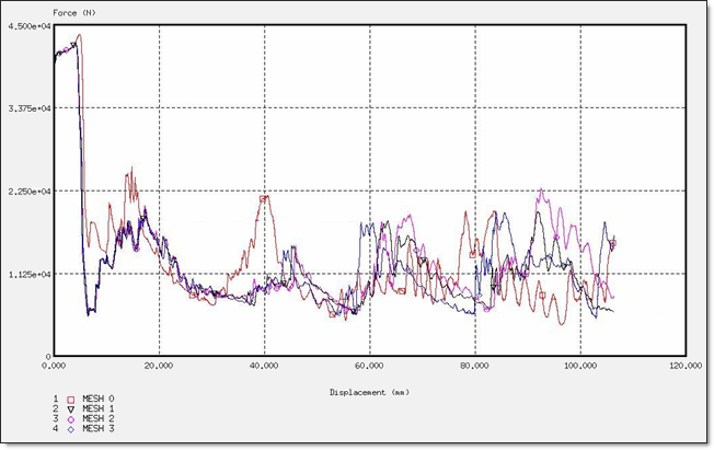

- Crushing force versus displacement
The crushing force corresponds to the normal force in the Z-direction of the impactor (rigid wall), multiplied by 4 due to symmetry.
For comparison, displacement corresponds to the Z-direction motion of the rigid wall's main node.

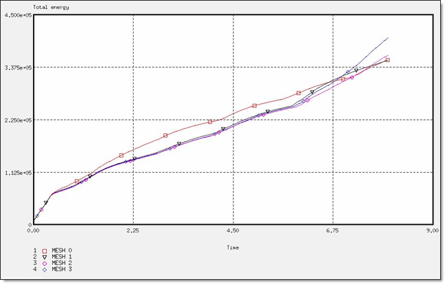

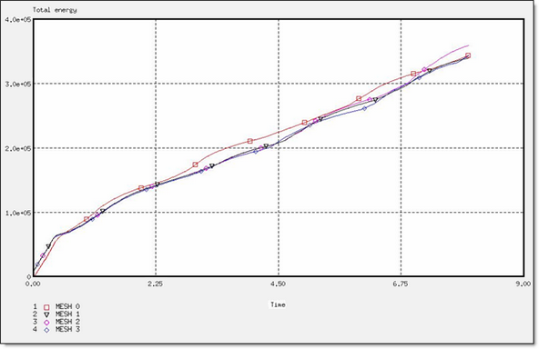

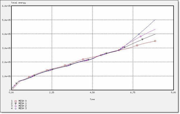

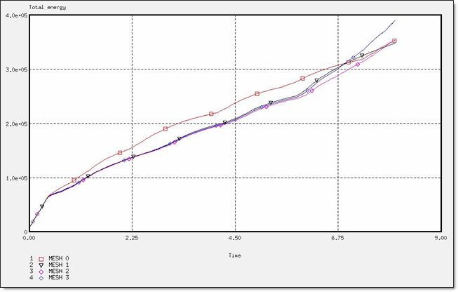

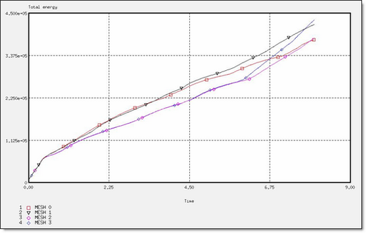

- Hourglass energy
- Total energy
Total energy is the sum of all energies.
