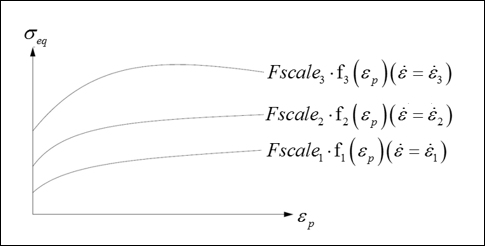

  7. The maximum number of curves is 10.
  8. If ε ˙ ≤ ε ˙ n , the yield is interpolated between fn and fn-1.
  9. If ε ˙ ≤ ε ˙ 1 , function f1 is used.
  10. Above ε ˙ max , yield is extrapolated.
    law57
