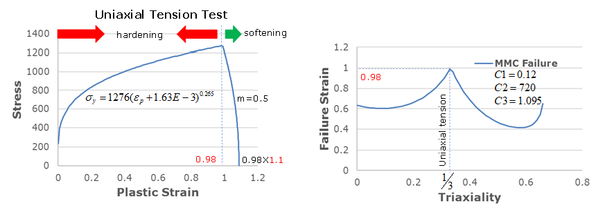

Example (Metal)
Material softening and failure are considered in the material example. Using the MMC parameters C1, C2, and C2 the failure strain in a uniaxial tension test is calculated to be 0.98. In a uniaxial tension test with m=0.5, the material starts to soften at 0.98 until 0.98 × D c MathType@MTEF@5@5@+= feaagKart1ev2aqatCvAUfeBSjuyZL2yd9gzLbvyNv2CaerbuLwBLn hiov2DGi1BTfMBaeXatLxBI9gBaerbd9wDYLwzYbItLDharqqtubsr 4rNCHbGeaGqiVu0Je9sqqrpepC0xbbL8F4rqGqFfpeea0xe9vq=Jb9 vqpeea0xd9q8qiYRWxGi6xij=hbba9q8aq0=yq=He9q8qiLsFr0=vr 0=vr0db8meaabaqaciGacaGaaeqabaWaaeaaeaaakeaacaaIWaGaai OlaiaaiMdacaaI4aGaey41aqRaamiramaaBaaaleaacaWGJbaabeaa aaa@3E4D@ is reached.

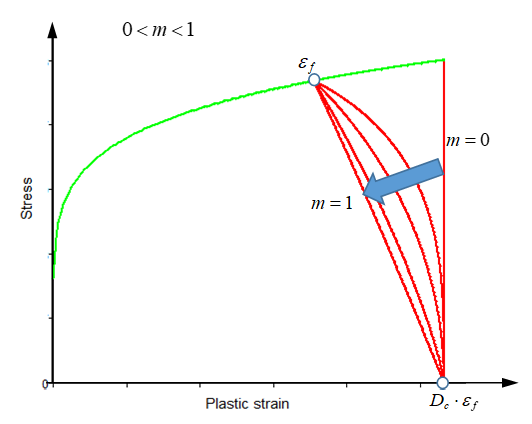

  3. Fracture and damage with MMC fracture criteria:
    • When D = 1: fracture initiate
    • By 1 < D < Dc: the yield stress is multiplied by softening function β to reduce the deformation resistance.
      σ y = β σ y 0 ( ε p + ε p 0 ) n with β = ( D c − D D c − 1 ) m 0 < β < 1
    • If D ≥ Dc, the element is deleted.

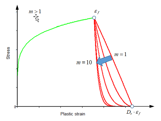

    • The exponent m is used to describe the softening behavior. It is recommended to use m > 0.
      If 0 < m < 1, then the softening curve is convex.
      If m > 1, then the softening curve is concave. The softening is between ε f MathType@MTEF@5@5@+= feaagKart1ev2aaatCvAUfeBSjuyZL2yd9gzLbvyNv2CaerbuLwBLn hiov2DGi1BTfMBaeXatLxBI9gBaerbd9wDYLwzYbItLDharqqtubsr 4rNCHbGeaGqiVu0Je9sqqrpepC0xbbL8F4rqGqFfpeea0xe9vq=Jb9 vqpeea0xd9q8qiYRWxGi6xij=hbba9q8aq0=yq=He9q8qiLsFr0=vr 0=vr0db8meaabaqaciGacaGaaeqabaWaaeaaeaaakeaacqaH1oqzda WgaaWcbaGaamOzaaqabaaaaa@3A25@ and D c ⋅ ε f MathType@MTEF@5@5@+= feaagKart1ev2aaatCvAUfeBSjuyZL2yd9gzLbvyNv2CaerbuLwBLn hiov2DGi1BTfMBaeXatLxBI9gBaerbd9wDYLwzYbItLDharqqtubsr 4rNCHbGeaGqiVu0Je9sqqrpepC0xbbL8F4rqGqFfpeea0xe9vq=Jb9 vqpeea0xd9q8qiYRWxGi6xij=hbba9q8aq0=yq=He9q8qiLsFr0=vr 0=vr0db8meaabaqaciGacaGaaeqabaWaaeaaeaaakeaacaWGebWaaS baaSqaaiaadogaaeqaaOGaeyyXICTaeqyTdu2aaSbaaSqaaiaadAga aeqaaaaa@3E56@ . Once the plastic strain is reached D c ⋅ ε f MathType@MTEF@5@5@+= feaagKart1ev2aaatCvAUfeBSjuyZL2yd9gzLbvyNv2CaerbuLwBLn hiov2DGi1BTfMBaeXatLxBI9gBaerbd9wDYLwzYbItLDharqqtubsr 4rNCHbGeaGqiVu0Je9sqqrpepC0xbbL8F4rqGqFfpeea0xe9vq=Jb9 vqpeea0xd9q8qiYRWxGi6xij=hbba9q8aq0=yq=He9q8qiLsFr0=vr 0=vr0db8meaabaqaciGacaGaaeqabaWaaeaaeaaakeaacaWGebWaaS baaSqaaiaadogaaeqaaOGaeyyXICTaeqyTdu2aaSbaaSqaaiaadAga aeqaaaaa@3E56@ (in this case D > D c MathType@MTEF@5@5@+= feaagKart1ev2aaatCvAUfeBSjuyZL2yd9gzLbvyNv2CaerbuLwBLn hiov2DGi1BTfMBaeXatLxBI9gBaerbd9wDYLwzYbItLDharqqtubsr 4rNCHbGeaGqiVu0Je9sqqrpepC0xbbL8F4rqGqFfpeea0xe9vq=Jb9 vqpeea0xd9q8qiYRWxGi6xij=hbba9q8aq0=yq=He9q8qiLsFr0=vr 0=vr0db8meaabaqaciGacaGaaeqabaWaaeaaeaaakeaacaWGebGaey Opa4JaamiramaaBaaaleaacaWGJbaabeaaaaa@3B15@ ), then the element is deleted.
      Figure 3.
