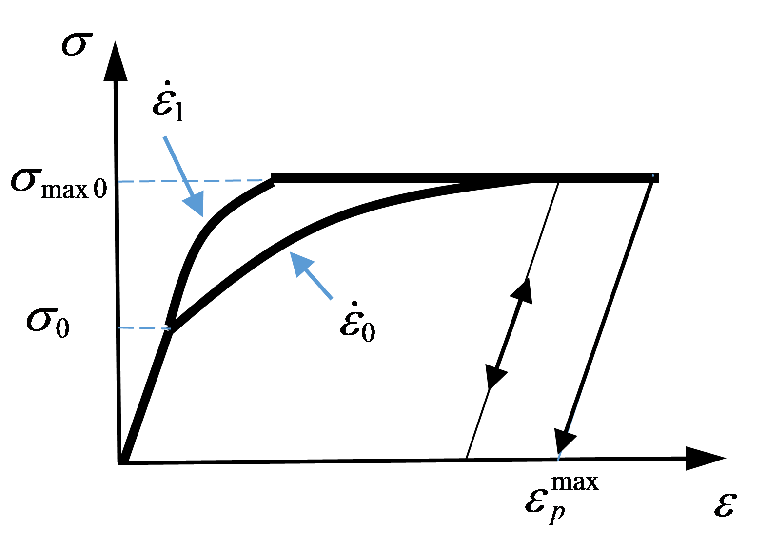

  2. The yield stress is compared to the equivalent stress:(3)
    σ e q = A 1 σ 1 2 + A 2 σ 2 2 − A 3 σ 1 σ 2 + A 12 σ 12 2
    mat_law32_yield_stress
