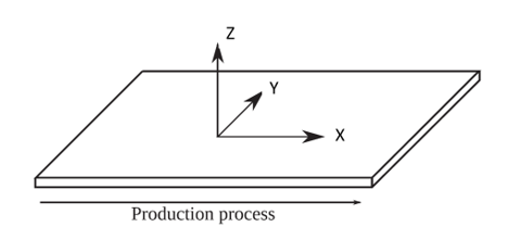

- To describe the
behavior of the paperboard material law, the following orthotropic direction
is considered.
Figure 1. - The elastic behavior
