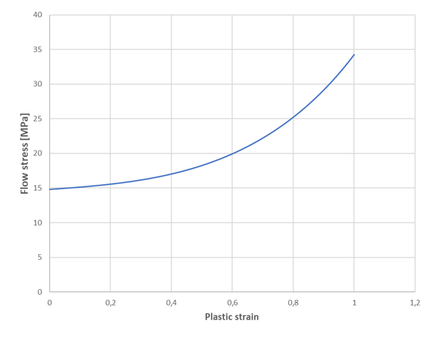

(4) With the flow stress defined by (Figure 1):(5) Where,- Initial flow stress.
- Linear hardening modulus.
- Densification strain.
- Nonlinear hardening modulus.
- Nonlinear hardening exponent.
Figure 1. Flow stress evolution with plastic strain - Two versions of

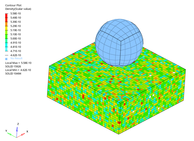

- When using
Istat =
1, the card /PERTURB/PART/SOLID must
be set to create the initial foam density
distribution over all elements of the part (Figure 2).
Figure 2. Example: foam density distribution in a foam block for an impact simulation - Most failure criteria are compatible with /MAT/LAW115; however, element deletion can be onset by you, if and/or are different from 0. The element deletion will be onset if the tensile volumetric strain is higher than and/or, if the first principal stress is higher than .
