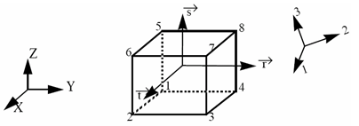

- Orthotropic reference frame (1, 2, and 3) is defined in the appropriate property set of each finite element.
- The global frame is ( , , and ).
- The local frame is (
, and
- The law is othotropic, E33 = E22 and G13 = G12.
