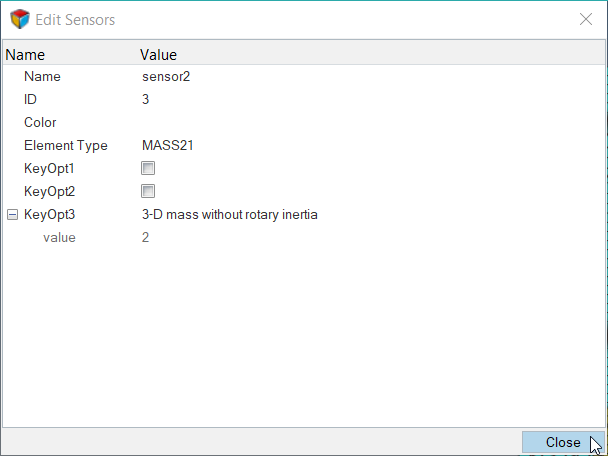

Create and attach the MASS21 element type to the mass
component.
Right-click on Type and select
Create from thecontext menu.
The Create Sensors dialog opens.
Set Element Type to MASS21.
- MASS21
- A point element that can have up to six degrees of freedom: translations in the nodal x, y, and z directions; rotations about the nodal x, y, and z axes. A different mass and rotary inertia may be assigned to each coordinate direction.
- Defined by a single node, concentrate mass components (Force*Time²/Length) in the element coordinate directions and rotary inertias (Force*Length* Time²) about the element coordinate axes. The element coordinate system may be initially parallel to the global Cartesian coordinate system or to the nodal coordinate system (KEYOPT(2)). The coordinate system rotates with the nodal coordinate rotations during a large deflection analysis. Options are available to exclude the rotary inertia effects and to reduce the element to a 2-D capability (KEYOPT(3)). If the element requires only the mass input, it is assumed to act in all appropriate coordinate directions.
- Set KeyOpt3 to 3-D mass without rotary inertia.
Click Close.
HyperMesh creates and attaches the new sensor to the mass component.
