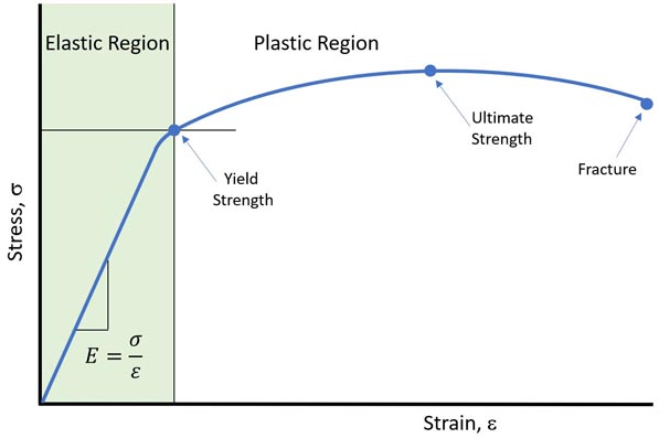

- Material properties define the structure and thermal characteristics of
each part. In SimSolid Cloud, materials are assumed to
remain in the linear-elastic region of the stress-strain curve for
structural analysis. That is, strains are assumed small (<0.2%) and
material properties do not change with load or time.
For structural analyses, only density, Young’s modulus and Poisson’s ratio must be defined. Additionally, material yield strength is used to calculate factors of safety. For thermal analysis, only thermal conductivity and the coefficient of linear expansion are required.
