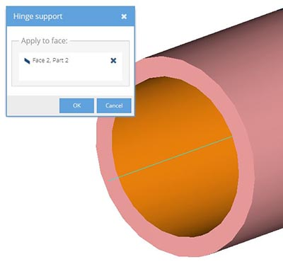

Hinge support
Hinge supports allow a part to freely rotate about the center-line of a cylindrical face but constrains movement in both the radial and axial directions. Hinge supports can only be applied to full or partial cylindrical faces. The cylindrical faces may be either concave or convex.

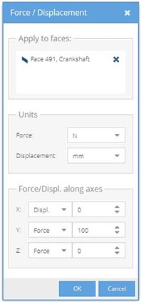

Force/Displacement
Both force and prescribed displacement are defined in a single dialog. Force is defined as a load on the model. The specified value is interpreted as a total force applied to all selected part faces. Loads and prescribed displacement can be specified in global X, Y and Z directions only.
Figure 2. Example of prescribed "0mm (fixed) displacement in X and a 100 N force in Y applied to single face
