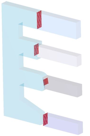

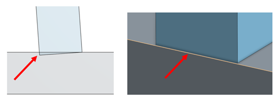

In traditional FEA, part connections can be problematic. Parts that visually appear to be connected (Figure 1) have geometric imperfections that cause numeric issues for the FEA solver (Figure 2). The result is often that the assembly must be edited or even merged into one monolithic geometry to create a single mesh. This can lead to additional problems with stress concentrations at the part boundaries and is not recommended. In SimSolid Cloud, parts are never merged.

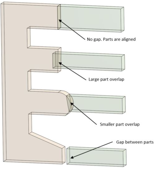

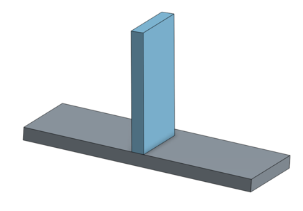

SimSolid Cloud is very tolerant of part geometry imperfections. Small gaps or overlaps between parts can be easily accommodated. Using only 3 parameters (gap tolerance, penetration tolerance and connection resolution), SimSolid Cloud creates a proprietary connection entity between each part in the assembly. Then, with each solution pass, the traction forces in the connection are measured and the solution is locally adjusted to minimize solution errors in the boundaries. In this way an accurate solution is obtained on the real, not merged, geometry. Examples of permitted connections are shown in Figure 3 and Figure 4.

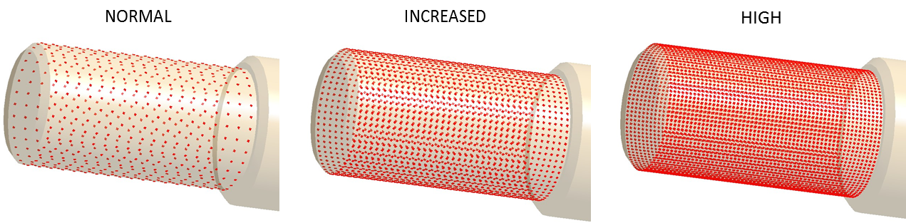

Connection Resolution
Connection resolution defines the mathematical completeness of the connection entity. Three settings are possible: Normal, Increased, and High. While details of the equations are not important to the user, be aware of regions where connections may not be adequately defined.
In SimSolid Cloud, connections resolution is visualized by icon density.
Figure 5.
In the majority of cases, the default Normal resolution is adequate. Note that Increased is 4X the density of Normal and High is 16X denser. More complex boundaries slow down solution time. It is recommended that the resolution level be only increased locally where required and try Increased first then High as a last resort.
Tip: Make sure there is adequate coverage in thin or curved regions. Look at the icon density and increase it locally as required. Care must be taken that connections don’t create hinges (allow rotation between parts). This causes structural instability during the solution process.
