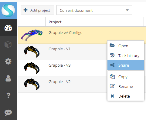

  1. Open the SimSolid Cloud dashboard.
  2. Right-click on the desired project and choose Share from the context menu.

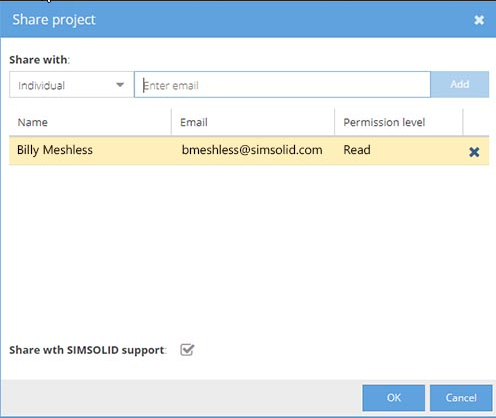

  3. In the Share project dialog, specify who to share the project with, along with access and permissions.
    You may share with other specified users that have valid SimSolid Cloud user ID’s and only Read access is allowed.
    Note:
    • There is also an option to share the model with SimSolid Cloud support by selecting the check box at the bottom of the dialog.
    • SimSolid Cloud projects are stored separately from the corresponding Onshape doc. Sharing is done separately as well. Sharing a Onshape document does not share the corresponding SimSolid Cloud project. These both need to be shared independently.

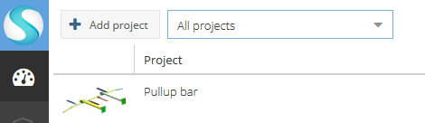

  4. Select the Project filter pull-down menu to see what projects are shared.
    Figure 3.
    By default, this is set to show all projects. You can also select: Owned by me, Shared with me, Shared by me and Shared with SimSolid support.
