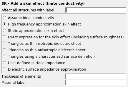

Figure 1. The SK - Add a skin effect (finite conductivity) dialog.

- Thickness of elements
- The thickness d of the surface elements in metres (if an SF card is present, this is always scaled).
- Material label
- Label of the material which will be used (as specified in the DI card).
