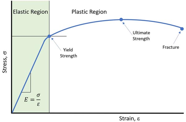

In SimSolid, materials are assumed to remain in the linear-elastic region of the stress-strain curve for structural analysis. That is, strains are assumed small (<0.2%) and material properties do not change with load or time.
For structural analyses only density, Young’s modulus, and Poisson’s ratio must be defined. Additionally, material yield strength is used to calculate factors of safety. For thermal analysis, only thermal conductivity and the coefficient of linear expansion are required.
