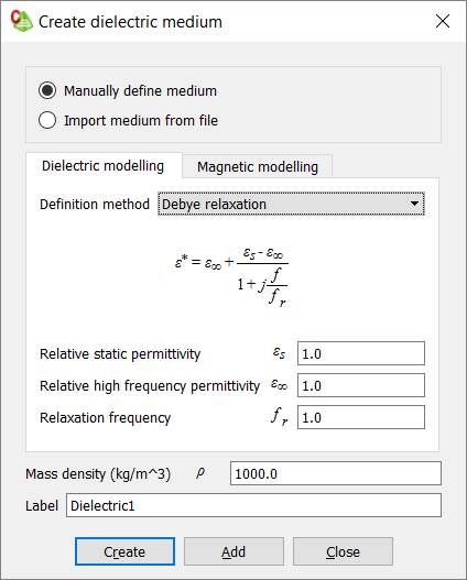

Create a frequency-dependent dielectric using the Debye
relaxation method. Use the Debye model to describe the relaxation
characteristics of gasses and fluids at microwave frequencies. It is derived for freely
rotating spherical polar molecules in a predominantly non-polar background.
On the Construct tab, in the Define group, click the Media icon. From the drop-down list, select the Dielectric medium icon.
Figure 1. The Create dielectric medium dialog (Debye relaxation).
In the Definition method field, from the drop-down list select Debye
relaxation.
In the Relative static
permittivity field, enter a value for εs.
In the Relative high frequency
permittivity field, enter a value for ε∞.
In the Relaxation frequency
field, enter a value for fr.
[Optional] Specify the magnetic properties of the
dielectric.
[Optional] In the Mass density
(kg/m^3) field, enter a value for ρ.
In the Label field, enter a
unique label for the dielectric.
Click Create to create the
dielectric and close the dialog.
