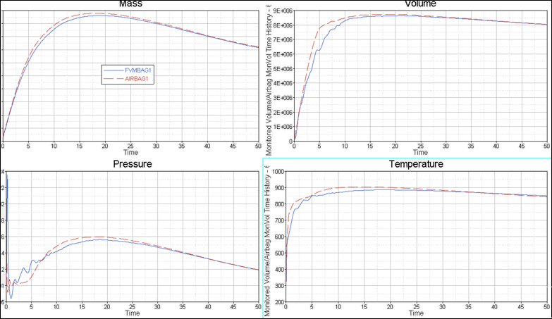

The gas motion inside the airbag should be reviewed by contour plotting the animation output of the temperature and velocity of the gas. The motion should clearly develop from the inflator into the airbag volume and account for the airbag topology (internal walls, baffles, vent holes, etc.).
Figure 2. Comparison of airbag output for AIRBAG1 and FVMBAG1 simulations
Figure 3. Comparison of venting parameters for AIRBAG1 and FVMBAG1 simulations
The vent area and vent outflow should be plotted for each vent and controlled and compared to uniform pressure run.
