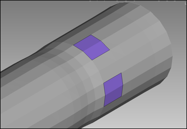

The gas generator model should represent all details available in CAD data: gas generator, injector openings, and retainers.
Figure 1. Inflator and Injector Elements
The injection direction is opposite to element's normal. Elements from different injectors should not share common elements. Radioss will assume that the element belongs to the last defined injector. Elements from a vent hole or porous surface also should not share common elements with injectors. Radioss automatically excludes the elements from vent or porous surface definition.
The injector surface can also be defined on an internal surface insideof airbag volume. In this case the gas flow direction is opposite to the internal surface element's normal.
