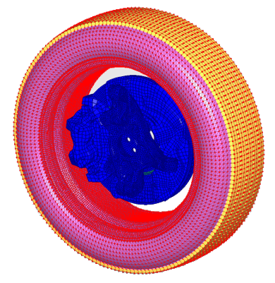

Figure 1.As the penetration in the contact increases, stiffness increase leads mass to be increased to maintain time step constant.
Figure 3.For example, the tire stack up against the rigid barrier. Behind the tire, the brake disk (or caliber) compresses the tire against the barrier. The global contact is not stiff enough and leads to large penetrations.- Stiffness increased
- Mass is added to maintain time step constant
Figure 4. Local contact
Contact between two rigid parts is possible with interface TYPE7 and TYPE11 or TYPE19. The main issue is that it will generate deep penetrations in the contact, which can lead to mass being added to maintain the timestep to the value specified in /DT/NODA/CST or /DT/NODA/CST2.
- Switch at least one of the parts to deformable
- Add a local contact with a higher gap and stiffness

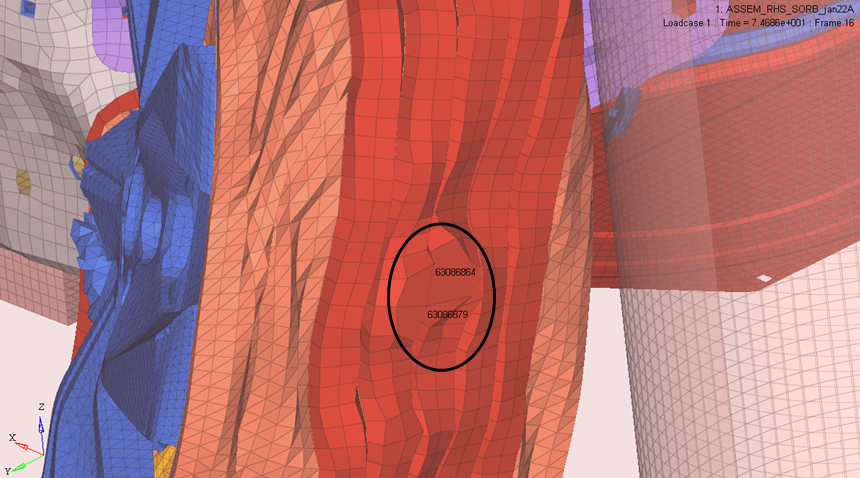

MASS OR ENERGY ERROR DUE TO HIGH DISTORTION
*** NODES WITH HIGHEST VELOCITY
*** NODES WITH HIGHEST MASS CHANGE
Figure 5.
- Define proper strain failure
- Material may be incorrect (unit system) or type (plastic instead of steel, yield point is too low…)
Figure 6.
Initially, there is an intersection that generates the local distortion. To resolve this issue, correct the intersection and define proper strain failure in the material.
