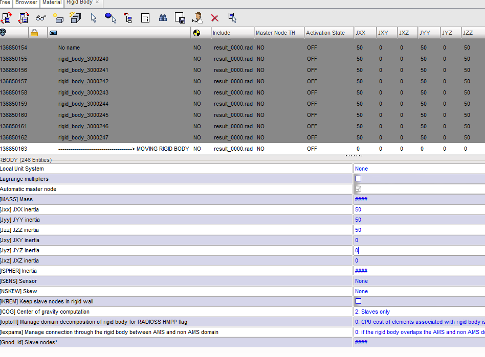

- Inertia have been defined but incorrectly in the case of Icog=3 and 4.
- Constant inertia has been defined (50) for Jxx, Jyy, Jzz, Jxy, Jxz and Jyz and Isphere is not set to 1.
This warning must be corrected as it could generate problems during the Engine. This can be corrected in HyperCrash.

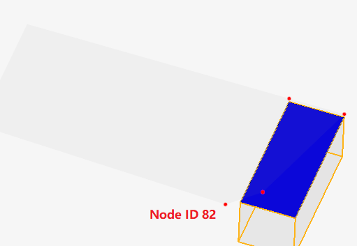

CONCERNING 1 NODE(S)
SECONDARY NODE: 82 NEAREST SEGMENT : 1 MAIN NODES: 146 145 142 143
S = 1.400000000000 T = 1.160000000000 DIST = 2.9393876913398E-02
82 is outside the main segment, but Radioss treats the projection as moving this secondary
node onto the nearest edge of the segment. S and
T are the distance of local 's' and 't' direction.
