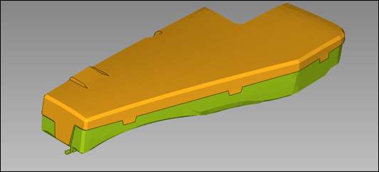

Airbag Housing
The airbag housing should represent all details available in CAD data.
Figure 1. Airbag housing
When the airbag will be included in a full vehicle simulation, the mesh size and quality should be similar to the full vehicle. Material laws LAW2 and LAW36 can be used to model elasto-plastic materials. Materials with failure should be used to reproduce the opening of the airbag cover.
Solid foam components should be modeled using LAW38 or LAW70, whereas hyperelastic components are modeling using LAW42.
Element properties for shell /PROP/TYPE1 should use Ishell=24 to avoid hourglass effects. For solid foam or hyperelastic components, use /PROP/TYPE14 with Isolid=24 and Ismstr=10.

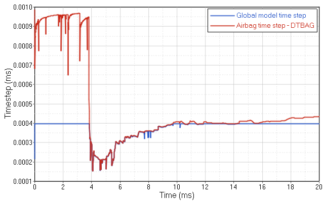

Since there is no gas motion, the initial time step is the characteristic length divided by sonic velocity of air at a room temperature. As the injection starts, the gas velocity and gas sonic velocities increase and the time step normally drops during a short phase after the time to fire. In this phase the time step may become less than the target structural time step and thus control the time step of the run. However, after some time (normally 5-10ms) the gas velocity is decreasing and the time step and becomes higher than the structural time step. It is important to minimize the length of time that the airbag time step is the lowest time step in the simulation.
The characteristic length is underestimated in the simulation because it is based on the minimum edge length of the folded airbag. Thus, the time step can be increased by making a value greater than 1 in /DT/FVMBAG/1.
Figure 2. Typical time step evolution for a model with FVM Airbag (red is the global time step, blue is the FVM time step) . FVM airbag is controlling the time step from 3.75ms to 7.5ms)
