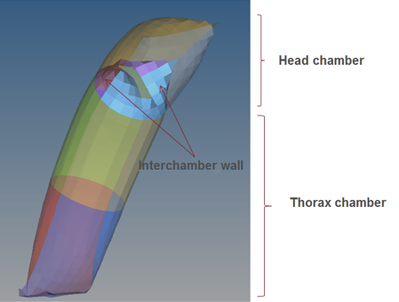

Internal surfaces (internal walls, baffles, etc.) shall be defined as a collection of components and referenced in the surf_IDin field.
Figure 1. Simple sleeve Airbag with 2 chambers

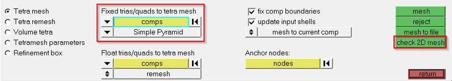

The Initial Finite Volume mesh is created automatically when the option /MONVOL/FVMBAG1 Kmesh=14 is used and no manually created initial tetra Finite Volume mesh is defined as described in the next section. Next, the airbag is checked to make sure no intersections exist in the airbag external and internal surfaces. If no intersections exist, the Finite Volume mesh is created. If the Finite Volume mesh cannot be created due to intersections in the airbag components, an error message is written with the possible node/element numbers and positions that are causing the problem with creation of Finite Volume mesh. When this happens, HyperMesh can be used to inspect and correct the issues with the airbag mesh. Use the check 2Dmesh option in the tetramesh panel, with default setting to see if the external and internal airbag components are acceptable for tetra mesh generation. Tetra mesh created by Radioss is output as Radioss include file MONVOL.

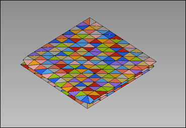

Figure 3. Representation of Initial Finite Volumes in *A000 File
The number of tetra elements depends on the complexity and the type of airbag. For example, a side airbag can be about 30,000 – 50,000 tetras, and a curtain airbag 250,000 – 500,000 tetras.
