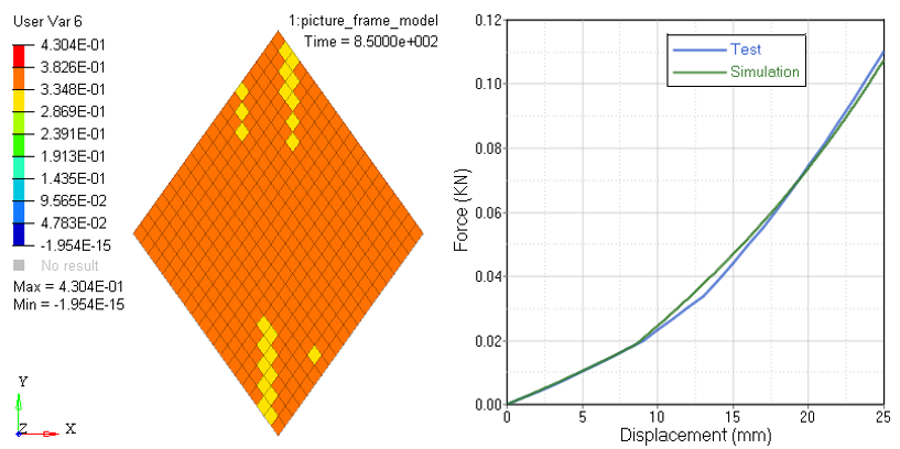

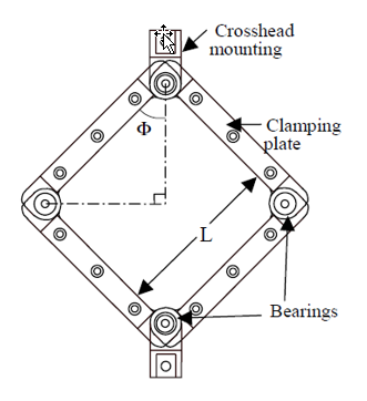

Figure 1. Picture Frame Shear Rig
- and
- Vertical displacement of the upper corner of the specimen
- Side length of the specimen
- Measured force
- Fabric thickness
Figure 2. Picture Frame Simulation and Shear Stress as Function of Anisotropy Angle
Cyclic loading and unloading picture frame tests can be performed to extract the loading and unloading curves in shear. The curves can be directly used as input in LAW58 material. The curves should be specified both for the negative and positive values of anisotropic angle in degrees.

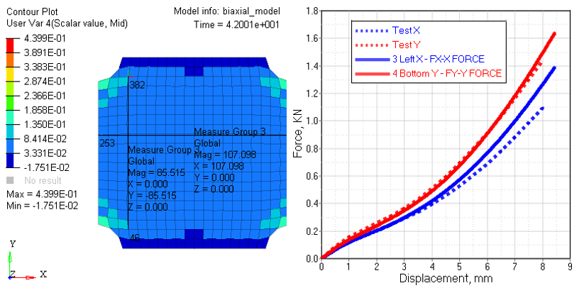

Figure 3. Biaxial Simulation and Forces Displacement Curves in Warp and Weft
DirectionsThe force displacement curves for warp and weft direction can be recalculated into stress and strain curves using size and thickness of the specimen. Due to corner boundary effects, slight scaling or other tuning of the input curves may be necessary.
