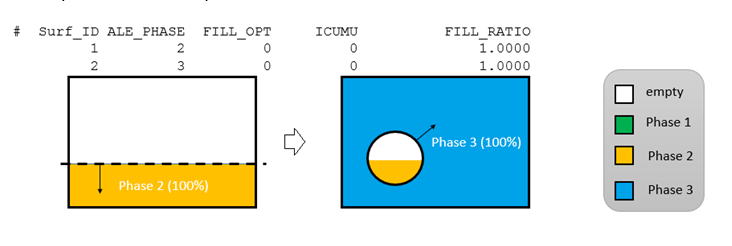

- ICUMU flag can be
used to add another material to a volume. For this purpose a
FILL_RATIO must be provided. By default,
ICUMU=0, which means that the existing
volumetric fraction initialized with a previous /INIVOL
process will be erased.
Figure 4. Filling with ICUMU = 0, erase existing filled volumes (default behavior)During the 2nd step, the volume outside the disc is filled with the phase 3 material.
