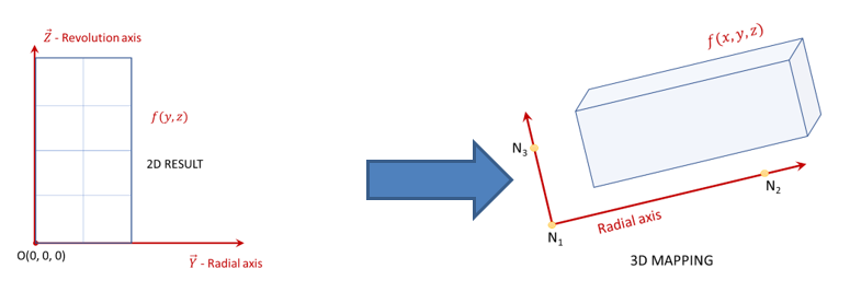

- node_ID1, node_ID2 and node_ID3 define the local coordinate system used for mapping.
Figure 1.2D Original Model 3D Target Model Note: The coordinate system ( , , ) does not have to be orthogonal, as an orthonormalization of the vector is performed during the Starter. - If explosive material LAW5 (JWL) is
